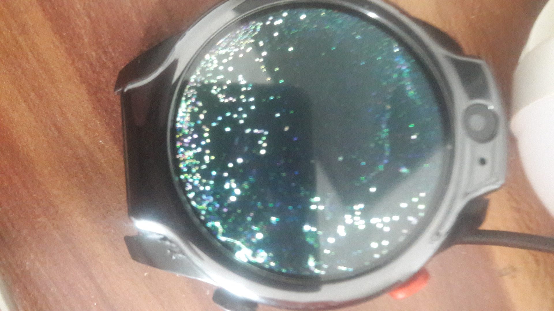

Where can I get an LCD touchscreen for the Lemfo Lem14? I've tried searching but I can't find it. Please help me.
Moved this to the correct place for ease of understanding @King_Store
______________
Aliexpress is only option… or Alibaba. I very much doubt that lemfo or Rogbid would be able to help, but you can always try and visit their website and send them a message for customer support and advice. I doubt if they would answer though. Another problem is that different screens were used during the production cycle. Which ended at least 5 years ago roughly….
It’s not a user replaceable part. Not even for someone who has been doing this stuff as a hobby for years. The only option is to see if you can get the part (parts actually) and see if you can find a very skilled mobile phone repair service that may help you.
Have you seen the detailed information about how a guy here tried to replace a part in the LEM14? It’s very interesting. :+1:
Check out this thread and video.
Probably more on YouTube as well:
Thank you for the info. Yes, I have tried to look at the marketplace but I couldn't find it. I will try to chat with them. I have tried to see why this screen is not responding and I took it apart, it turned out that the flexible part was broken and when I put it back together, the screen was like that because the liquid in the screen came out.
Yes, I am not surprised.
As I said before, it’s actually two parts. The screen and the digitiser. Sometimes sold together as an LCM. But, I really want you to understand that these are very custom screens and this one has not been on sale for over 3 years at least. I wanted to make sure that you understand this because there is almost no chance that you will be able to find one.
If you search for it on Aliexpress and find nothing, it is extremely unlikely that you will be able to get the part. This is just the reality of the situation.
Sorry it’s not better news.
