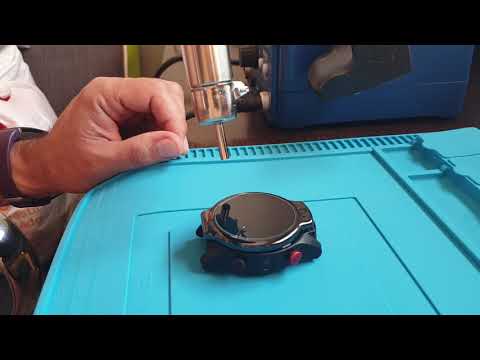

I just found this for you. Disassembling the lemfo 14 is not an easy task.
I’d rather wait a week. See if the battery runs out by then.
Very true . Not a easy task after watching that video
Yes, the LEM 14 rear cover is not removable and you need a heat gun to remove the front bezel.
