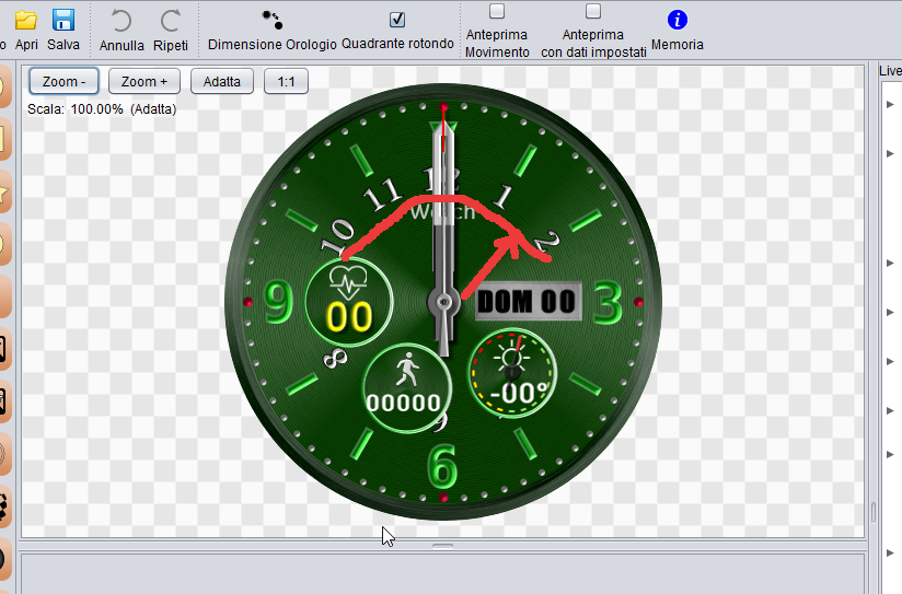

I have a question about the rotate by day function.
I made a watch using this function:
The preview looks good but when i install the face on my watch it shows 31 as the day (and it’s february 2th today).
Is this a bug or am i doing something wrong?
Greetz Bert

UPDATE!
I manually set some different dates on my watch and this is what’s happens:
Day 1 becomes 1
Day 2 becomes 31
Day 2 becomes 30
Day 3 becomes 29
Day 4 becomes 28
etc etc
I made a Textlayer for the number 1 to 31
Auto Rotation is set to ‘Day of Month’
Auto Rotation Direction is set to ‘COUNTER_CLOCKWISE’
Tried to make a GroupLayer and set the Rotation settings on the group but that has the same results.
Any ideas?

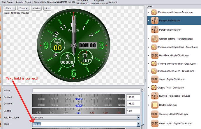

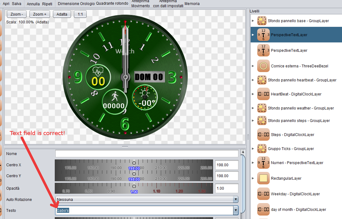

Marco, a little bug report (but minor issue, though).
In WFD, when you open a saved clockskin with a Text Perspective Layer where I changed “12,1,2…” to a fixed text (ex. “Gabo’s” or whatever), sometimes it is restored to default “12,1,2…” on the watch.
Since on the text field there’s the correct modified value, I can just edit the field (for instance, pressing space and backspace) to make it redraw correctly even on the designer panel.
(… but if I don’t realize and I export clockskin, the default “12,1…” value will be exported).
Best regards,
Gabo
Feb 3, 2018 1:45:22 GMT 1 gabolander said:
Marco, a little bug report (but minor issue, though).In WFD, when you open a saved clockskin with a Text Perspective Layer where I changed “12,1,2…” to a fixed text (ex. “Gabo’s” or whatever), sometimes it is restored to default “12,1,2…” on the watch.
(… but if I don’t realize and I export clockskin, the default “12,1…” value will be exported).Best regards,
Gabo
Yes, I reported that some posts before. The text is correct, but numbers are displayed instead.
Bye!

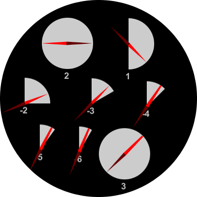

Marco - I noticed that Movements Preview for battery isn’t OK for 90 degrees dials.
In the documentation of clockskin format there is information that: “When mulrotate is set to anything else than 2, the hand moves from 0° to 180°, when set to 2 the hand moves from 0° to 360°”.
But it isn’t true. It’s possible to set it to -2. I have this rotation for example in my Citizen watch face - plus.google.com/u/0/103206577381367015648/posts/1gx6h8P2VND . Please check it on the watch - this power hand rotates correctly with -2 value of mulrotate.
You can also check tests of Alessandro Limonta: plus.google.com/u/0/112553839840359721091/posts/7V2ELbdJHvt and plus.google.com/u/0/112553839840359721091/posts/3pZL1WvvzM3
Feb 3, 2018 23:03:55 GMT 1 jacek said:
Marco - I noticed that Movements Preview for battery isn't OK for 90 degrees dials. In the documentation of clockskin format there is information that: "When mulrotate is set to anything else than 2, the hand moves from 0° to 180°, when set to 2 the hand moves from 0° to 360°". But it isn't true. It's possible to set it to -2. I have this rotation for example in my Citizen watch face - plus.google.com/u/0/103206577381367015648/posts/1gx6h8P2VND . Please check it on the watch - this power hand rotates correctly with -2 value of mulrotate. You can also check tests of Alessandro Limonta: plus.google.com/u/0/112553839840359721091/posts/7V2ELbdJHvt and plus.google.com/u/0/112553839840359721091/posts/3pZL1WvvzM3
Ok, so that means that negative mulrotate work as usual, by dividing 180 by abs(mulrotate) right? So, a mulrotate of -2 is 90º, -3 is 60º, -4 is 45º, -5 is 36º, and so on?
I did follow the documentation, that’s why I only had implemented the 360º and 180º support. At the time I didn’t have an Android watch, so I could not test it…
Feb 3, 2018 23:33:21 GMT 1 mpmf said:Feb 3, 2018 23:03:55 GMT 1 jacek said:
Ok, so that means that negative mulrotate work as usual, by dividing 180 by abs(mulrotate) right? So, a mulrotate of -2 is 90º, -3 is 60º, -4 is 45º, -5 is 36º, and so on? I did follow the documentation, that's why I only had implemented the 360º and 180º support. At the time I didn't have an Android watch, so I could not test it...
Perhaps... I used only 90º rotation in my watch faces - this Citizen, Montblanc Nicolas Rieussec, Chopard Superfast Power Control - always with mulrotate = -2. I didn't test other values.
Ok. I'll check it out this week... Thanks.
It's confirmed. All values are permitted for the mulrotate on the power rotation. So,
| mulrotate value | Angle Span |
| 3 | 540 (1 and an half turn) |
| 2 | 360 |
| 1 | 180 |
| -2 | 90 |
| -3 | 60 |
| -4 | 45 |
| -5 | 36 |
| -6 | 30 |
I attach the clockskin I used for testing.
