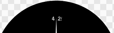

I try to add textlayer with days numbered 1-31 with this new property. Numbers scrolls in window counterclock rotation and seems to work good, but.... Leftmost start point for drawing numers is shifted right on every day changes. Auto rotation multiplier set to 1.00
Please make sure you didn’t forget any day (or have one on excess). I’ve just tried it out and it works perfectly, without any left or right shift… Since yours is shifting to the left, I’d bet you forgot one number…
Please make sure you didn't forget any day (or have one on excess). I've just tried it out and it works perfectly, without any left or right shift... Since yours is shifting to the left, I'd bet you forgot one number...
You must have right. I checked it again and all works good. Thanks for help. Ad. sliders - you propably right. I'll have to learn to live with it

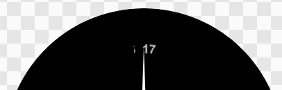

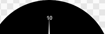

I’ve got an idea (and implemented it to test it). I will add another property on the Perspective Text Layer for specifying the position regarding the radius. The options will be: INSIDE (the text will be inside the radius), CENTERED and OUTSIDE. With these options, it will be almost equivalent to RIGHT JUSTIFICATION, CENTER, LEFT JUSTIFICATION, respectively, on “Whole Text” rotation styles. I’ll add one more, DEFAULT, for compatibility with previous versions (because the default was outside on all rotation styles except “Whole Text”, where the default was inside). This property will be available to all rotation styles, except None (which, in my mind, make no sense - until I see the light, of course ).
Does this looks ok?
It sounds good Marco. We will see.
