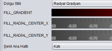

I am doing the Turkish translation of the program.
But in some places, when I translate it looks like the picture below.
How can I fix this?
Feb 27, 2018 7:16:16 GMT 1 yakazan said:
Hi First of all thank you for such a good practice. I am doing the Turkish translation of the program. But in some places, when I translate it looks like the picture below. How can I fix this?
Those are the keys that are not yet present on the translation file. If my translation tool doesn't show them that's because not even I had translated the yet . You can fix it by adding those strings to your translation file. Just open them in a text editor and add at the bottom of the file something like this:
FILL_GRADIENT=your translation for fill gradient here
It should do the trick

Feb 27, 2018 16:16:50 GMT 1 mpmf said:Feb 27, 2018 7:16:16 GMT 1 yakazan said:
Those are the keys that are not yet present on the translation file. If my translation tool doesn't show them that's because not even I had translated the yet . You can fix it by adding those strings to your translation file. Just open them in a text editor and add at the bottom of the file something like this:FILL_GRADIENT=your translation for fill gradient here
Hi
I did not do the process you said.
I will wait for the new translation.
Thank you
