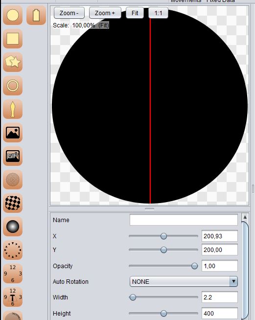

Hi everybody!
Bug (or strange behaviour at least): RECTANGULAR LAYER: When setting HEIGHT to <= 2.2, it draws a point, no matter what value in WIDTH. This situation, in WFD early versions, drew a line. I usually do this to make lines, markers or whatever you want to call it, to help me aligning objects, mainly hands.
However if you change the values, I mean WIDTH <= 2.2 and HEIGHT any (high) value, it draws a line, in last version, what is the right behavior I think
So please Marco if you can take a look at it I would be very grateful.
I attach examples of both situations…

Hi everybody!
Thank you for the bug report. I’ve just fixed it. I’ll release the fixed version in 5… 4… 3… 2…

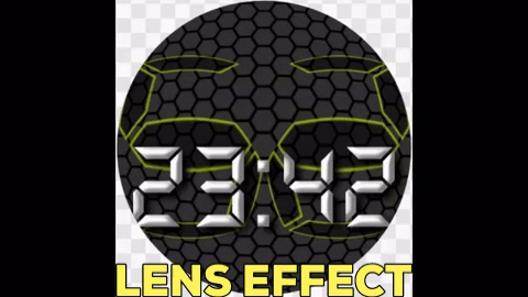

WatchFace Designer v. 0.10.1
Here is a small incremental release. It is mainly a bug fix with a new feature added: Lens effect. This effect will distort the layer it’s applied to in order to (badly) simulate a fish-eye view… Since a picture is worth more than a thousand words, here is a gif (it seems to be trendy right now ) showing the effect. The same font is used for the seconds and the hours/minutes. But a lens effect has been applied to the background and to the seconds digital clock layer…
Here is the download link: goo.gl/qCG7TW

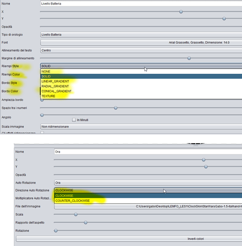

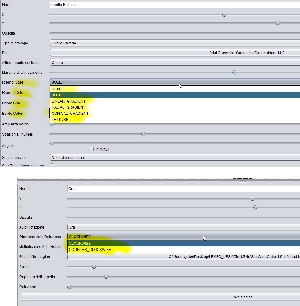

Oh well ... Honestly, I must admit that maybe at almost 50 yo I realized to know better english than my motherlanguage (italian, indeed!) LOL 😂😂
… just kidding, but banding jokes … I explain what I mean: as often happens, in different sentences some english words may have more meanings and translations in italian, depending on the context where they appear.
For this reason, I have to check my translations in the different part of the application, if they can stay or if they are really ugly.
So I ask you to try to apply my translation’s xml that I’ve already done, attached here, and share me somewhere your temporary application version, so I can take a look to all the program and check if the jobs is correct, before publishing it definitively.
Keep present the following things:
  1. I dunno if single quotes on descriptions (') are good or may give issues and have to be escaped (eg., \').
  2. I dunno if accented letters (several in italian language) have to be escaped or localized in utf-8 in your apps. Eventually they could be converted in their corresponding html code for HTML parts (eg., è for è, etc.)
  3. Note for you: I realized that CREATE_DIGITAL_CLOCK_LAYER and CREATE_CHARGING_ICON_LAYER entries, have the same title and description in original translation file (maybe for a copy&paste and a tweak missing.. may happen  ). I already corrected (I think) the italian side.
  4. Note for you: I didn't find any entries in the original file, for customizing the entries for the SELECT adaptors of the programs, such as "ALWAYS, INVERT_BOTTOM, LINEAR GRADIENT, HOUR_24, TEXTURE, etc.. Are they fixed string as of now, or missing somewhere else? Or simply is this the part you talked about, when you said "It may not be complete"? Need to know, because if they have to stays as is, I need to change some italian descriptions too accordingly, at least where they refer to those options..
Anyway, I can manage and reorganize italian translation each time you release a new application version. I give all my support for it as far as my possible…
At the moment, no more things come to my mind to tell you.
I look forward to hearing from you soon.
Best,
Gabo

Hi everybody!
Bug fixed! Great. Thanks a lot. That’s very useful to me.
Anyway, I can manage and reorganize italian translation each time you release a new application version. I give all my support for it as far as my possible...
Best,
Gabo
EDIT: Sorry, filename was bad, I corrected and re-uploaded here:

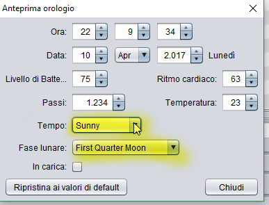

    I completed italian translations and verified along the program and I feel it looks good for now for the latest version of WFD. I leave you here: translations_it.properties (22.68 KB)
    Currently, I found some untranslated words/entries for:
    • All selectors of watch preview window, as highlighted here:
    • In some description like "Fill Style/Color", "Stroke Style/Color" (but only for Style and Color words) and some selector of the object/layers control windows, as highlighted here:
    For all the rest, it looks good so far, except for something I missed…
    Keep on the good work, hear you soon.
    Gabo
