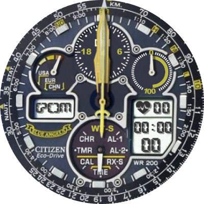

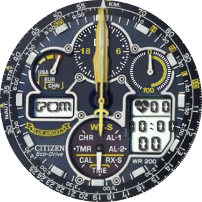

I’ve opened a proyect made with v9.x in v10 and digits in a DIGITAL CLOCK layer and digits are too separated from the others, while if opened in version 9.x they are together as were designed.
I’ve attached pictures. First v9, second v10.

Jan 5, 2018 2:16:43 GMT 1 tcc said:
Hi again!
In the DigitalClockLayer try setting the “Image Scale” to “SPECIFY_SIZE”, then you should be able to resize to fit with the Image Width & Image Height sliders.

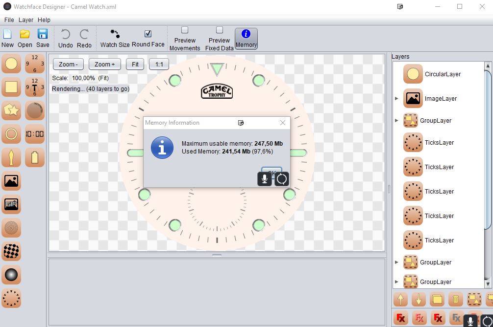

Check in the Memory info button on the top toolbar what’s the maximum available memory for WFD. If it is less then 4Gb, then redownload it again. I (want to but can’t) promise this will be the last time .
Hi I have checkt the Memory info button and noticed that the maximum usable memory is 247.50 mb  I have downloaded it again but nothing has changed it is still 247.50Mb

Thanks for your answer moviking,
I already knew that posibility. My comment was in case that would be a bug, and Marco could correct it in that case.
Those different behaviors are strange for the same layers with the same parameters, only change WFD version.
Thanks!
Jan 5, 2018 12:29:25 GMT 1 tcc said:
Jan 5, 2018 5:15:51 GMT 1 moviking said:
In the DigitalClockLayer try setting the "Image Scale" to "SPECIFY_SIZE", then you should be able to resize to fit with the Image Width & Image Height sliders.
Thanks!
Yes, that was actually a bug and a feature at the same time
It was a result of the optimizations that I made. Before the optimizations, each layer was rendered on a bitmap of 800x800 (to have space to spare). I optimized it so that each layer would only occupy the least space possible. But then a problem that already existed became apparent: the effects would not change the size of the layer, even if that clipped the effect (think of a shadow effect or a border effect, that acts outside of the original layer). So, to solve it I allowed effects to resize the layer bitmap as needed. And that’s the feature. The bug is that it also affected the effects applied to DigitalClockLayers. In your example, you had shadows added to the digits, so, in order to accommodate for those shadows, the digits would need to grow. You can notice in your previous version that the shadow on the far right of the 0 digit was indeed cropped. The bug is that that behavior (cropping), on DigitalClockLayers is usually the intended behavior
So, in order to solve this bug, I’ve reuploaded version 0.10.0 and now, on DigitalClockLayers you have a new option to allow the effects to resize the digits, or to not allow it. The default value is to not allow, resulting in (I hope) the same behavior of the 0.9.x versions. If you check it, then it will behave as the original 0.10.0 version.
So, please re-download it, test it and tell me if now it is ok
Are you sure that max memory is just 247.5 Mb??? That's really low! How much RAM do you have in your system?
If you are comfortable using the command line, can you run WFD by calling “java -jar WatchFaceDesigner.jar” (without the quotes and in the folder you have WFD)? If you’re able to run it, it should print out to the console something like :
Restarting to increase memory
Instance started with max memory set
if it does print that, then please tell me again what’s the maximum usable memory available on WFD. Thanks.
Hi Marco,
I have the same problem here.
Just 247,5 mb memory.
Started it with ‘java -jar WatchFaceDesigner.jar’ and this is the output:
Invalid maximum heap size: -Xmx16g
The specified size exceeds the maximum representable size.
Error: Could not create the Java Virtual Machine.
Error: A fatal exception has occurred. Program will exit.
jan 08, 2018 7:53:58 PM java.util.prefs.WindowsPreferences
WARNING: Could not open/create prefs root node Software\JavaSoft\Prefs at root 0x80000002. Windows RegCreateKeyEx(…) returned error code 5.
Rendering Rectangle took 64 ms
I have 16Gb Ram installed on my PC
Bert
