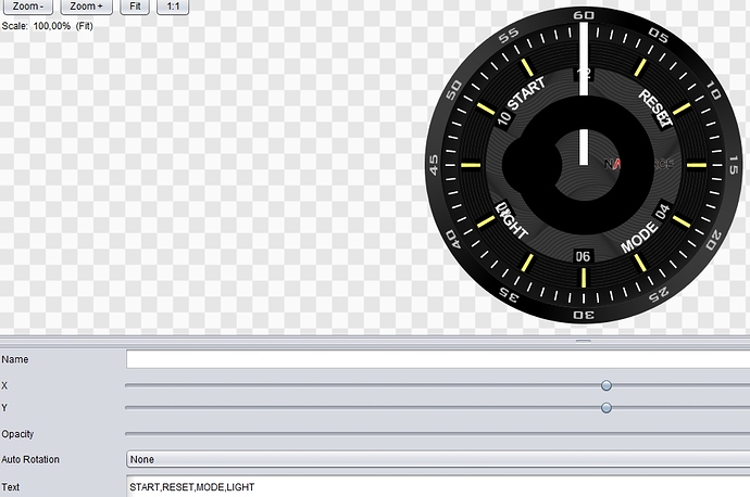

Yes, that super! My example is rotated object numbers or texts always facing the same side, because there is no hand just fixed marker.
Like here:
Marco, is possible to add a rotation type to the Text Layer, so that the most left digit (or the most right, with some angle parameter…) is always displayed straight when it rotates?
In the example you see in this attachment, I had to make it manually via Gimp…
T.I.A.
Gabo

This is actually what zsolt m just requested. I’ve already implemented it and it will be available on next release… A tough weekend is on the horizon, so I may not be able to release it this weekend, though.

Hehe, I’ve done that for other Diesel and similar for a Police. Had to make it from the scratch with the gimp, import as image layer and apply auto rotation type needed.
If this kind of movement could be done directly from WFD, it would be great and saves a lot of outer work.

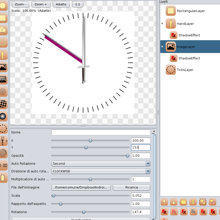

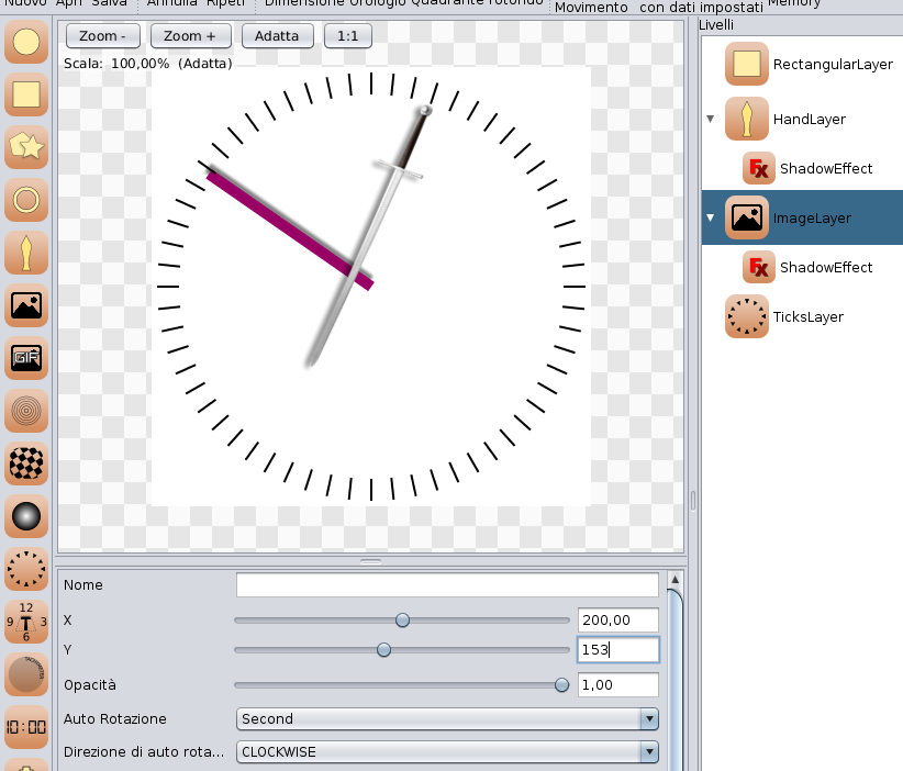

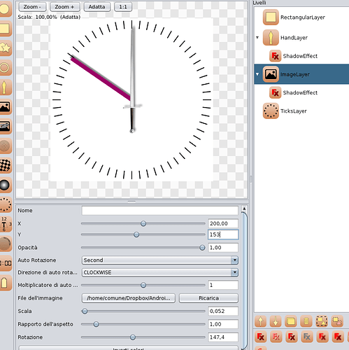

Hi Marco, just a couple of questions, suggestions.
  1. For instance, and for my curiousity in this skin (TheBlue) have you used images for the hands, or did you made them with the HandLayer of WFD? Because with Hand Layer, I couldn’t have those shapes, trying all parameters combinations. The maximum result using different effect, creatings hands only by WFD, is just the next one:
But I can’t, indeed, make elaborated hands without adding other circular layer (as I did for the seconds hand in my example), polygonal layer, etc… and making them rotate togheter with hands…
  1. I feel that some coordinates parameter is missing for those images we can import as an Image Layer, but we wont make them rotate like a hand (so as with Autorotation Type != None).
    I explain… Or I have an image that is already centered and the correct size (y=400), or I can’t scale and move an image in the Y coordinate, because WFD should change the “center of rotation” for it.
    Let’s see (as you mentioned, images are better than 1000 words. :-D)
In this picture I just imported, rotated and scaled the sword I want to use as a seconds hand. After scaling, the sword was too centered for my aim(x=200,Y=200)…  In fact, I wanted the Hilf of the sword, to be closer to the center of the watch, so I moved Y to 153…  In this case, it’s ok to 00, but of course it misalignes when it turns around, because it consider 200x153 as its center of rotation.
See the image when I am at 35 seconds:
Thus, should be an idea to add in WFD some sort of “Center Of Rotation X” and “Center of Rotation Y” parameters, when Autorotation Type != None ?
T.I.A.
Best,
Gabo

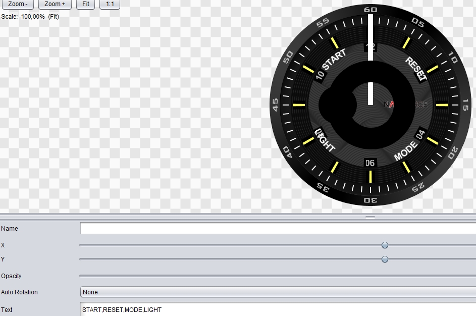

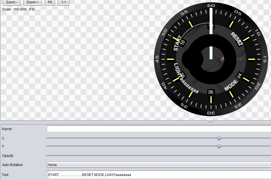

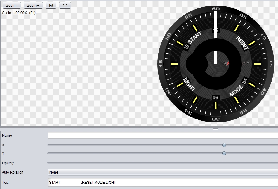

Little bug report for marco.
PerspectiveTextLayer create rounded text, divided according to number of strings enetered. That works OK in case of symmetricaly justified texts with similiar length but works wrong for asymmertical texts (with different lenghts).
When want to put rounded texts I have to use much PerspectiveTextLayer - as many as texts I want to place. It cant be corrected by adding spaces between text and comma separators. Space is ignored in Text property.
Besides… in once enetered text, adding some new chars causing outter limit exceding.
Normaly eneterd texts
No reaction on space chars
Outter radius exceding after some char added (only in one area, even if 1/4 of length is preserved)
Jan 15, 2018 12:04:32 GMT 1 gabolander said:
Jan 12, 2018 21:40:06 GMT 1 mpmf said:
Just released it: plus.google.com/+MarcoFerreira1976/posts/hcgg7JD8q5T
Hi Marco, just a couple of questions, suggestions. 1) For instance, and for my curiousity in this skin (TheBlue) have you used images for the hands, or did you made them with the HandLayer of WFD? Because with Hand Layer, I couldn't have those shapes, trying all parameters combinations. The maximum result using different effect, creatings hands only by WFD, is just the next one:
T.I.A.
Best,
Gabo
1) YEP, Hands design it’s the more difficult thing to handle to me in WFD. That’s why I’ve just requested a video tutorial to Marco a few posts ago.
  1. I agree. I had to deal with that situation since the firsts faces. I solve it with the Gimp, but I’ve always thought that an option to change the point of rotation it would be great.
