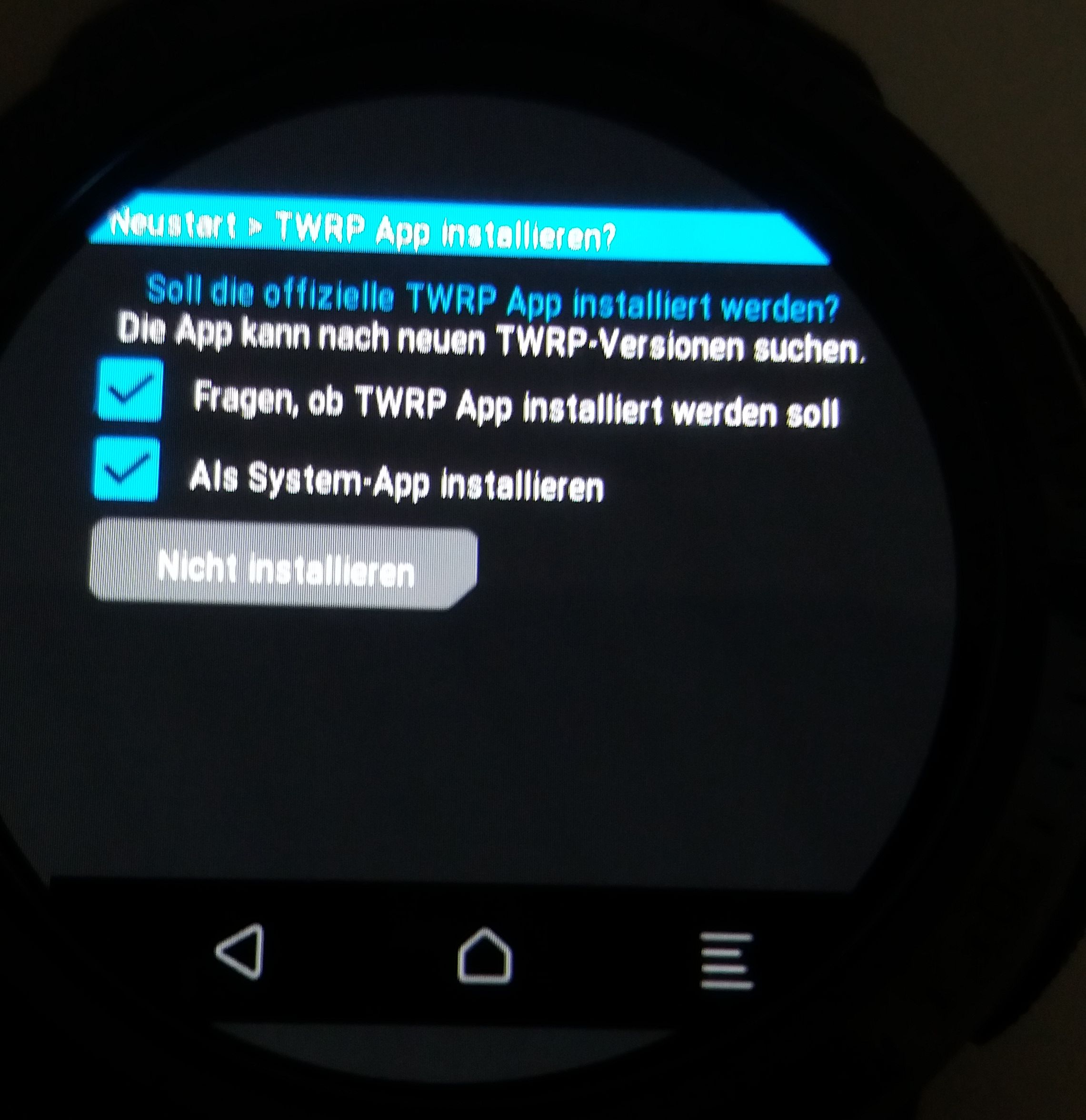

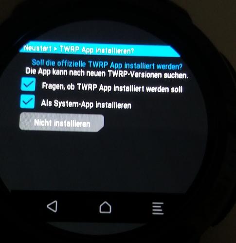

Hi. My problem is that TWRP is on watch, but when i will shut down and boot to system
i have this Screen:
On the screen is:
Restart - install TWRP App?
Should the official TWRP App be installed?
The app can search for new TWRP versions.
Case with tick: Ask if TWRP App should be installed
Case with tick: Install as a system App
Blue Case: Do not install
When i will push “install”, there is no way. This button is not possible…
What have i to do??
It doesn’t matter whether or not you install the twrp app, personally I prefer not to install it
Yeah me too, and it won’t even make sense cuz twrp for our watches isn’t officially supported
