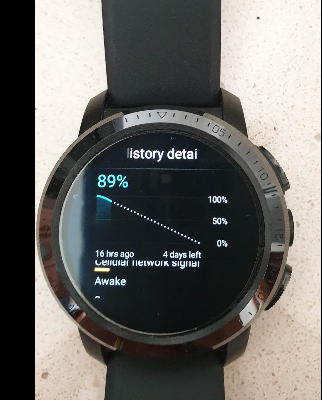

Wait a moment, if it doesn’t sleep, the Awake indicator should be filled: but it is empty.

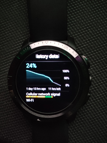

To me, it seems that the watch sleeps, but the battery lasts too few hours. Faulty battery.
This is mine, Awake indicator empty, sim on, this should be a normal lasting time.
if you tap on the dial but don’t select it, the battery savings will be 10 per night%

It was in a room with close to no signal and the battery life was nice till I moved out.
I’m not using a SIM but it still connects to a signal?
Can we turn it off?
Airplane mode is the only way to turn off the watch comms radio.
However, I don’t think the watch uses cell radio if no Sim is installed.
To be honest, I have not looked into it because I don’t seem to have the problems you are having.
Yes, it’s possible to have radio signal without a SIM card, but you only can dial an emergency number. I have test it with several mobile phones. So to save battery the only way is to switch off all GSM radios, or turning on flight mode in case you are not going yo use a SIM card.
It looks like the watch keeps the connection with the last tower with flight mode on till you move out of range. After that it stops using the GSM radio as intended.
