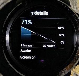

is it possible to make a simulated selection of the dial (by clicking on it and turning off the backlight of the screen). I think a lot of battery power is wasted on this at night

Hi,I made all the settings mentioned above,He rested on the desk all day (9 hours),Bt off,Wifi off,no simcard, this is the best time so far!
Can this be further improved?
Weird. It just doesn’t sleep. Maybe try this:
- goto settings
 - goto About watch
 - quickly tick kernel version 5 times (at the bottom of that page)
 - now you are in Mtk Engineering menu (be careful what you do here)
 - swipe to Hardware testing
 - select Non-sleep mode
 - the button should say “Enable Non-sleep mode”
If it says Disable… then click it.
EDIT: and try to put Airplane mode on for a change! (disables the GSM radio)
ok thank you,i test it!
