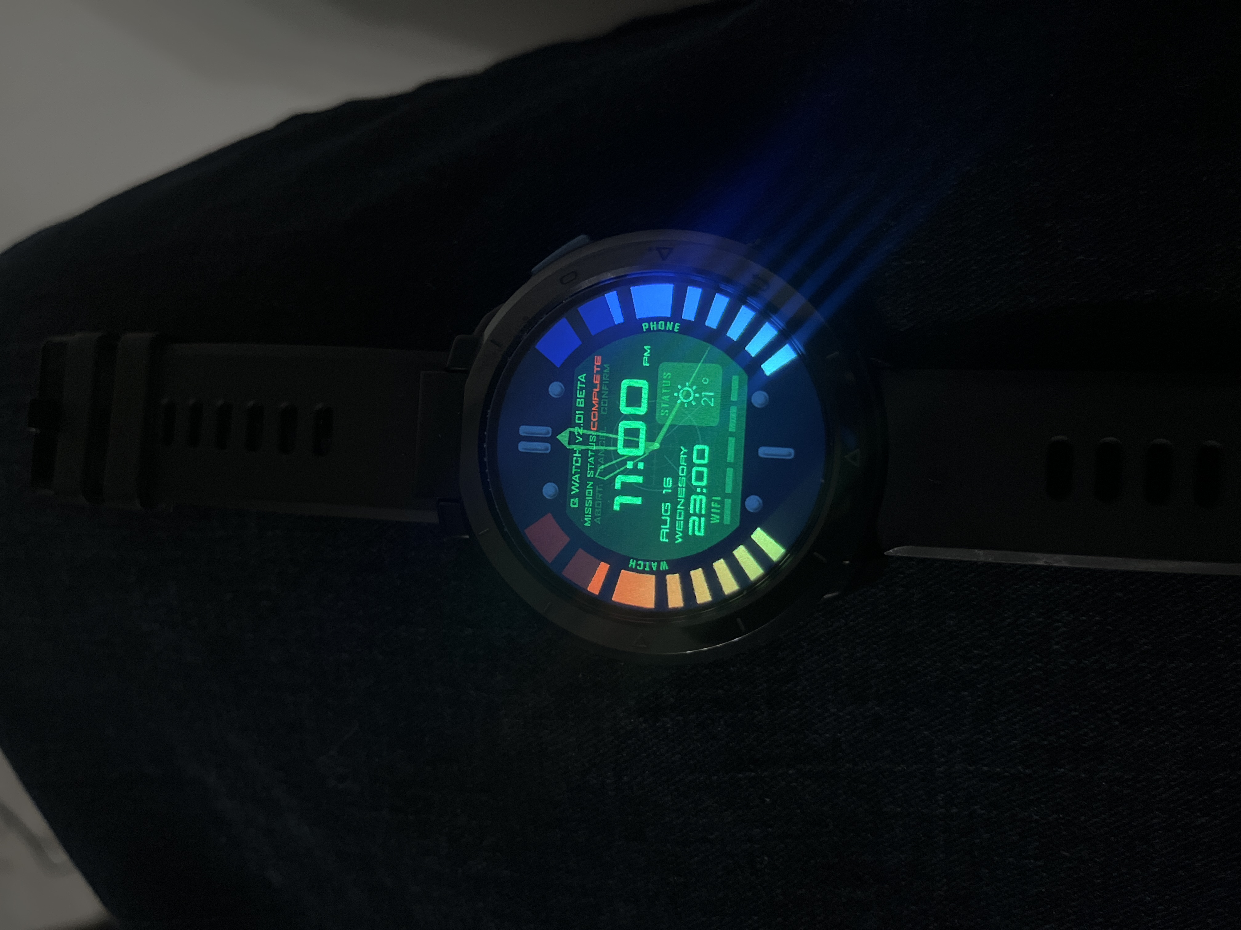

Thanks for this… I got watchmaker up and running! If anyone needs help with that let me know.
Watchmaker or the universal launcher?
We don’t talk about WearOS watches in this forum.
I am wondering, too. It seems to be a Ospet Primus pro. He’s talking about Universal Launcher, I guess.
the picture is a kospet optimus 2… im talking about getting wearos faces(.watch) files working with universal launcher.
yeah my bad… i meant “watchmaker faces” which is .watch files… was just excited to have all my faces from my old watch… pardon me lol
It’s fine, the confusion is about the Nubia device which is being discussed above your post.
No worries
