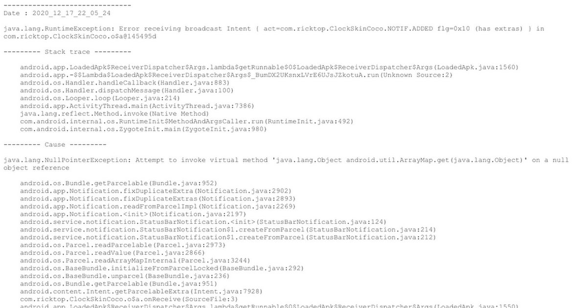

Maybe I spoke too soon - I’m getting reboots more often now with or without HR enabled. I still have no idea if reboots are causing UL to crash or vice versa, but here are a few more stack traces for Eric to mull over.
