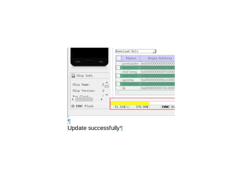

I’m jinxed. Flashtool not showing my device but “adb devices” is. USB driver installed OK it seems. Not seeing the device details in bottom left of flashtool, despite restarts. Screenshot from the kospet tutorial doc shows what I should see, but I dont. Not seeing metadata or yellow progress bar when I click “download”. What have I missed?
use firmware upgrade ( not download ) and make sure watch is turned off before putting on dock . Flashing should start .

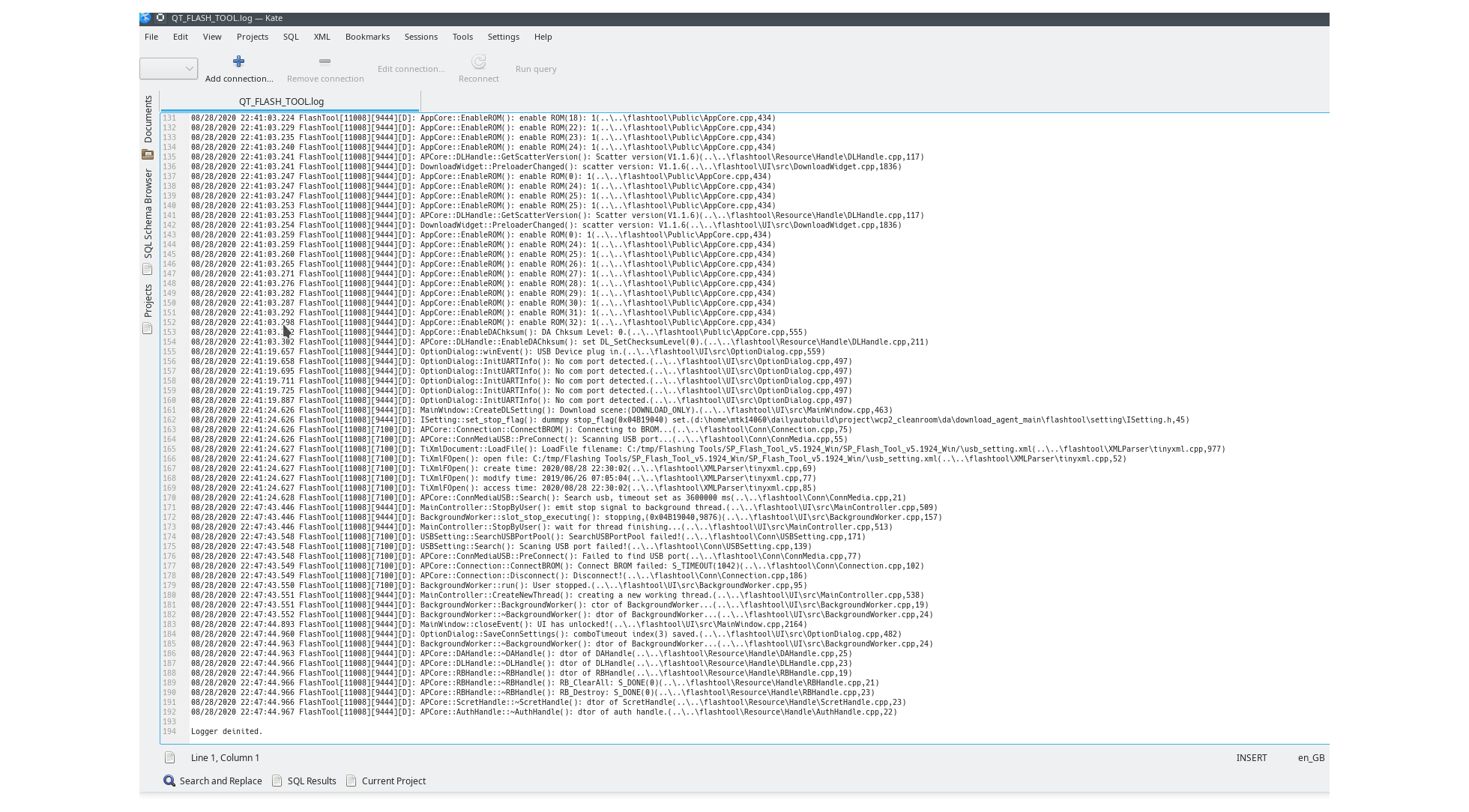

Have image of tail of flash log if its any assistance. Late now, giving up. May have inspiration tomorrow.
Have attached
Reinstall the drivers.
It seems that the vcom port is not operating when you connect to the watch.
If you are flashing twrp and patched boot you should remove the checksum generator exe and file, because obviously the different images are not the same as the original images so chesksum is broken.
thanks, I’ll try that, but had regen’d the Checksum.ini file and wasnt getting crc errors (tell me Im wrong). But definitely seems like vcom is the culprit - all the flash logs Ive looked at end with the same line… Have also found the linux tools at spflashtool.com but they’re qt4 based and Ive just purged that to work on qt5 for another project so I’ll thank you all again for your help and go away to solve that headache. In the meantime, I have factory reset the watch anyway and have working clockface directory and install and my deteriorating bluetooth issues (I never mentioned them! bluetooth sucks, always) have cleared up too.
For those interested, here’s a step-by-step “happy path” for root and flash of your Prime.
1. Download flash tool and firmware 2_3B
2. Download v1.5 also to get twrp recovery
3. unzip the v1.5 firmware on your PC
4. unzip your new firmware on your PC, e.g. v2_3B
5. copy “recovery_twrp.img” file from the img subdir of v1.5 into the v2.3b img folder. Rename as recovery.img (move the original to another location or rename it to something else beforehand)
6. if you also notice that there is no existing “magisk_patched.img” file in the unzipped firmware/img folder– you will have to use magisk to patch the boot file. Follow steps 1-8. Otherwise just do step 8.:
    1. install magisk on watch
    2. copy the v2_3b boot.img to watch e.g. to /sdcard/Download
    3. Rename as boot.png so that it will appear in the magisk file selector in 6.5 below*.
    4. Restart phone.
    5. Run magisk and from the two options provided select update magisk (not “update magisk manager app”) and choose “download and patch” image file.
    6. It will do everything and leave it as “magisk_patched.img” in your phone (/sdcard/Download folder by default)
    7. copy this to your pc from the phone (to the img sub-directory of the place you unzipped the firmware)
    8. rename this file now as boot.img (move the original to another location or rename it to something else beforehand)
7. On your PC, in the unzipped firmware/img directory update checksum.ini with the checksum of your new boot.img file. (or perhaps easier, run checksum_gen.exe in the firmware img folder)
8. Install and Start/run flash tool –
9. load the scatter file (in the firmware/img folder0. You should get NO errors when you load the scatter file
10. Connect the USB data cable and puck
11. Place the watch on the puck
12. Check the drop down on the top left of the panel says "download". Now click the download button. (should see metadata and yellow progress bar)...)
10. Factory reset.

I ran the USB driver installer again, it seemed to do the same thing as last night, Then came across this post at XDA, and it talked about clicking the download button before inserting the cable and puck, and then placing the watch (off) on the puck. So, I did that, and lo and behold it worked - download commenced, yellow progress bars and success message at the end. So, for now, it seems like I have a rooted watch, twrp and the 2_3b firmware (getting a wireless update message about a new version).
So, alls well that ends well!
