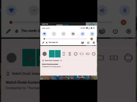

rotation control is the app i use but its not easy to use with the stock launcher i have to run an app called power shade to make the notification panel accessible all the time so you can get to the rotation control app easily !
