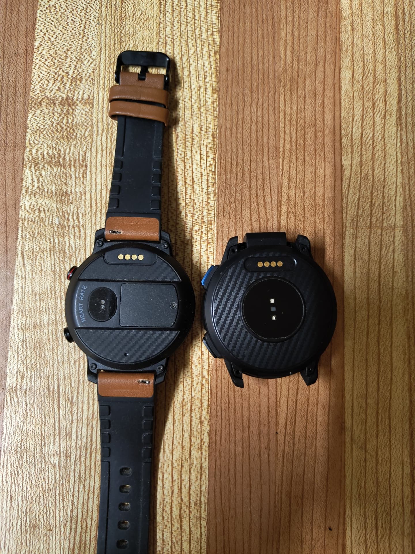

The support arm where my watchband attaches to my Lem12 Pro broke yesterday so I’m looking at the 128GB Optimus 2 to replace it. Does anyone know if the charging cables and charge dock are compatible between these two devices? They look similar, but I recall at least the Optimus Pro had warnings about different polarity on the charging cables. Would be nice to have an extra dock and cable with the new watch.
The cable will work. But I’m not sure about the charging dock.
As the pin layout is the same, cable should work.
But, I suspect that the rear cover of the two watches are different and therefore may not be able to sit on the same dock.
This shows what I mean…
Opt 2 is circular sensor array and LEM 12 is horizontal shape.
Both are raised and so will not be able to use the same dock.
Ah, I see. Thanks. Good to know the pins are compatible. In a pinch, I might be able to modify the old dock, but I plan to get the proper one when I order the new watch in any event. The picture comparison was very helpful!

I just checked the lem12 charging dock with the Kospet Optimus pro2. It works fine, although they have different backsides.
That is awesome. Thank you for testing it out.
