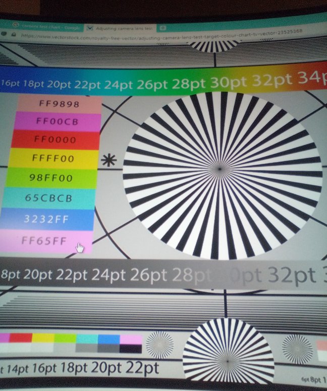

Here’s a couple I tried to get the same size on the camera screen. I seemed to have trouble orienting things from the side camera but I think they are fairly close. Both downsized and cropped a little bit but the originals were essentially showing the same width on screen. Note these are being taken on a curved screen monitor.
Kospet:
Rollme:
I’ve found information in that past that cameras for androids have sometimes considerable variance in quality between batches even on the same phone. Maybe I just got a marginal one on the Kospet Prime. In the pictures above I don’t see as much difference but the background ‘noise’ on the Kospet in an area where there is less light looks a lot more ‘noisy’. You don’t see that from taking pictures of a screen as much but it shows up a lot in regular pictures. It also seems to color from the Rollme is a bit more vivid in most pictures.

For the camera sensor, i guess you either got a really good BF2206 or a rather not so good GC5025, as (just compared to) the pixel difference is noticeable on the test pictures.
