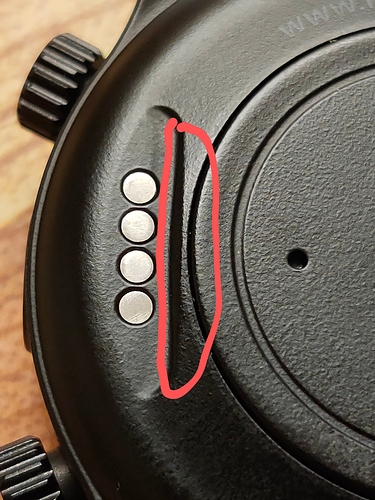

Ok guys,
After looking at the problem more closely and getting the same results on all firmware…
I believe it is this little hard shoulder causing the problem.
Unlike other devices this one has this right next to the connection pins
This makes it very difficult to keep the connector in the right place.
If it is done carefully and USB file transfer is enabled on the watch - I have managed to get good results.
However, it is not good because even a very slight disturbance causes a disconnect.
So it will need some modifications to the (preferably the cable connector)…
The other thing is oxidisation
This connectors need to be cleaned regularly.
I dont want to flash it but just transfer file like mp3 in the internal rom. Tried with dock and the other simple white USB data/charging cable. No way.

Then you’re very lucky, most of my watches suffer from this problem, it usually takes several attempts to find a good connection.

I’m actually assuming you are already aware of this but since I don’t believe it has specifically mentioned I think it is worth saying. And on the Rollme this can be difficult as touching the watch with it’s fairly weak magnet connection can be a little tricky. I have mine on a thin foam pad and tend to hold down on it while getting to the ‘Transfer files’ option so it won’t lose connection to the USB.
After looking closely at my plug, I noticed a small, protruding piece of plastic. I carefully removed it with a craft knife and file.
This solved the problem. I can now connect to the PC. It’s far away from perfect, but it works…
