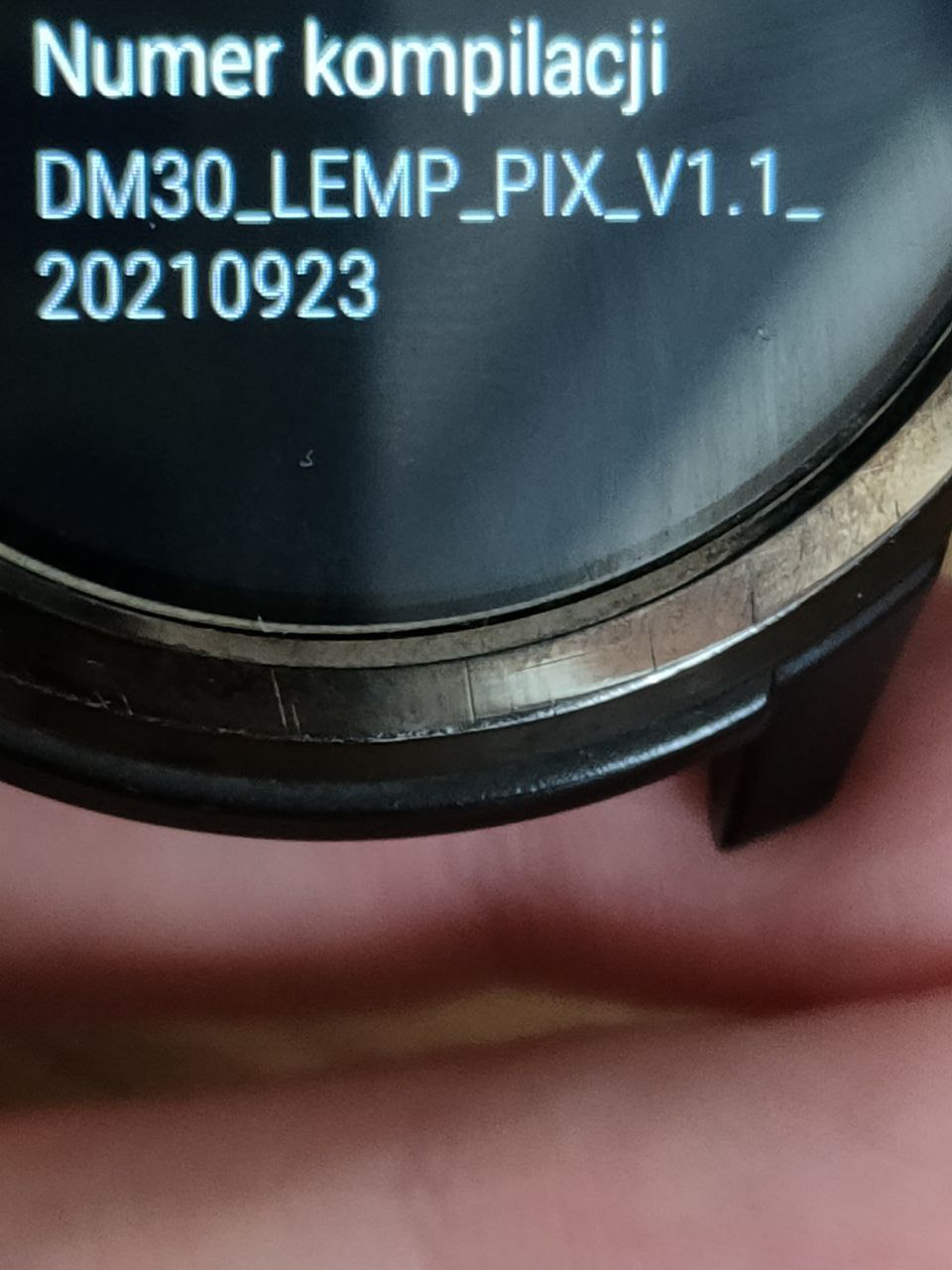

My goal is basically to root. So maybe I approach it wrong? Should I stick with SPD upgrade tool and just replace images for boot and vbmeta? Why do you say unlocking can be done without trouble? Little confusing…
this is the build number:

Found it
I guess you have seen this?
https://xdaforums.com/t/generic-sl8541e-sc8541e-information-about-generic-chinese-smartwatches-with-the-spreadtrum-unisoc-soc.4654255/page-17
