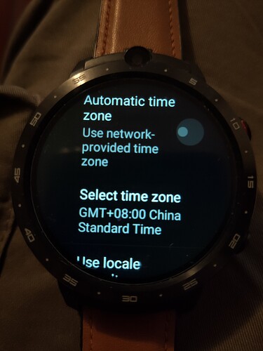

So you are in India and connected to Wi-Fi?
If you go to Settings and date and time and check the region - make sure it is set to your region and not China.
You have to uncheck the automatic time zone like this photo
My time zone was correct! But automatic time zone was on, disabling that does not help? Weather app still not working? Is it working on your watch?
