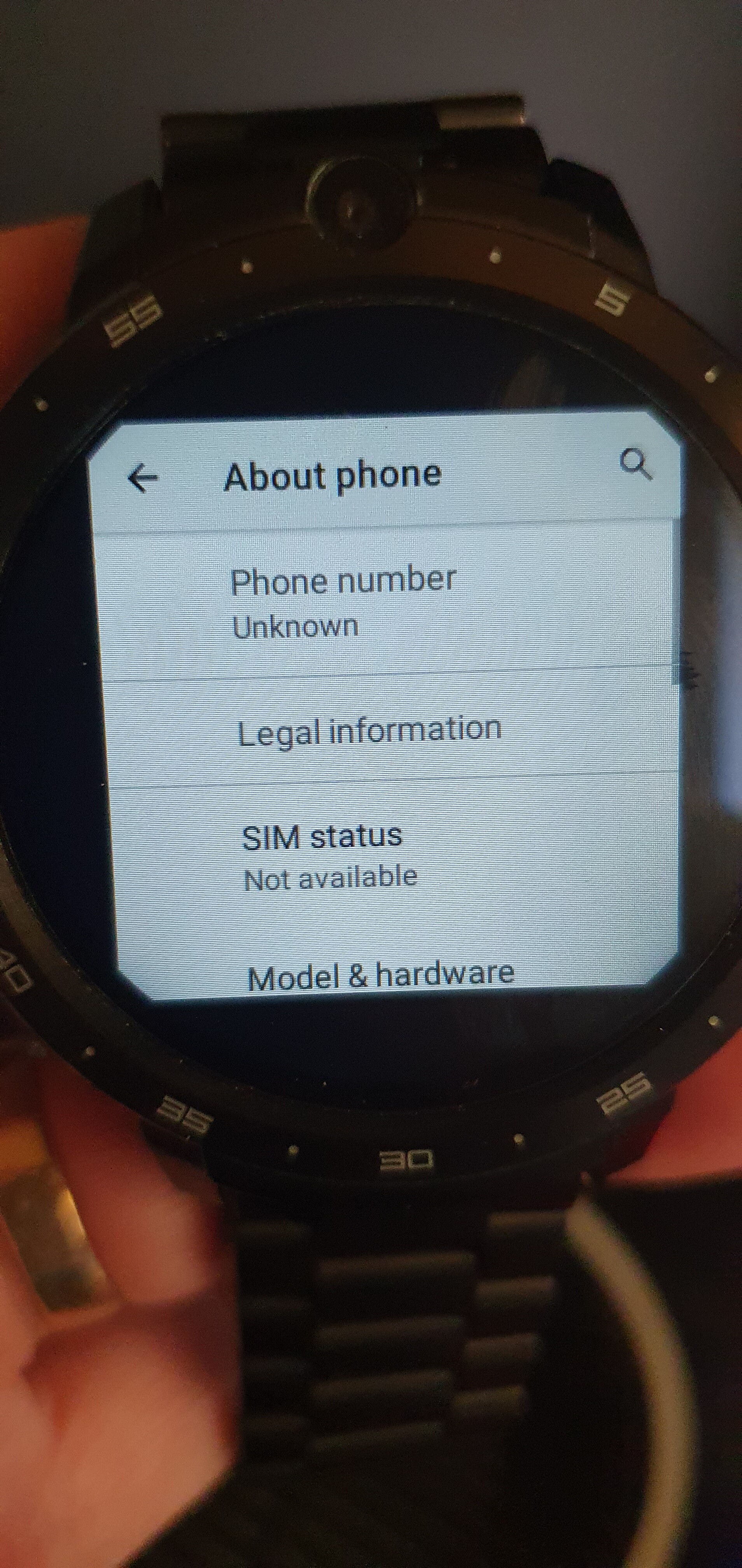

already have spare cable no joy,i think the ribbons loose .i know how to get the zip to my watch. with the FAW firmware im on theres no way of applying it or is there? thanks anyway im off to bed been at it all night 8:15am here :slight_smile:
Ok,

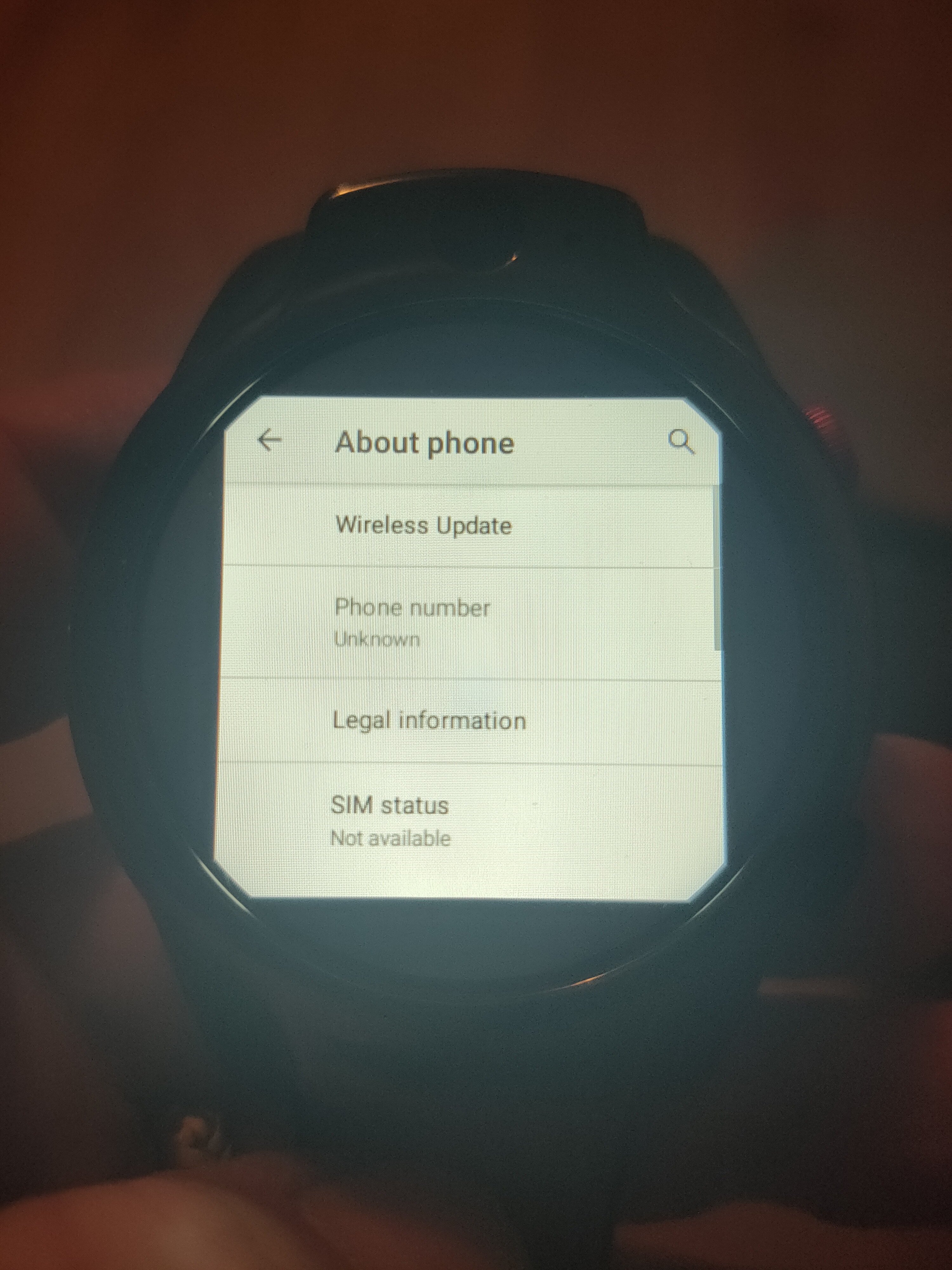

Well, when you are awake you can check in the settings app and open About Phone and look for the wireless update app at the top of the list…
If it is there, no problem.
If not you need to flash with a USB cable.

nope not there i thought there might of been another way to get wireless update on watch i guess not.
i cant connect with a usb cable thats the problem
