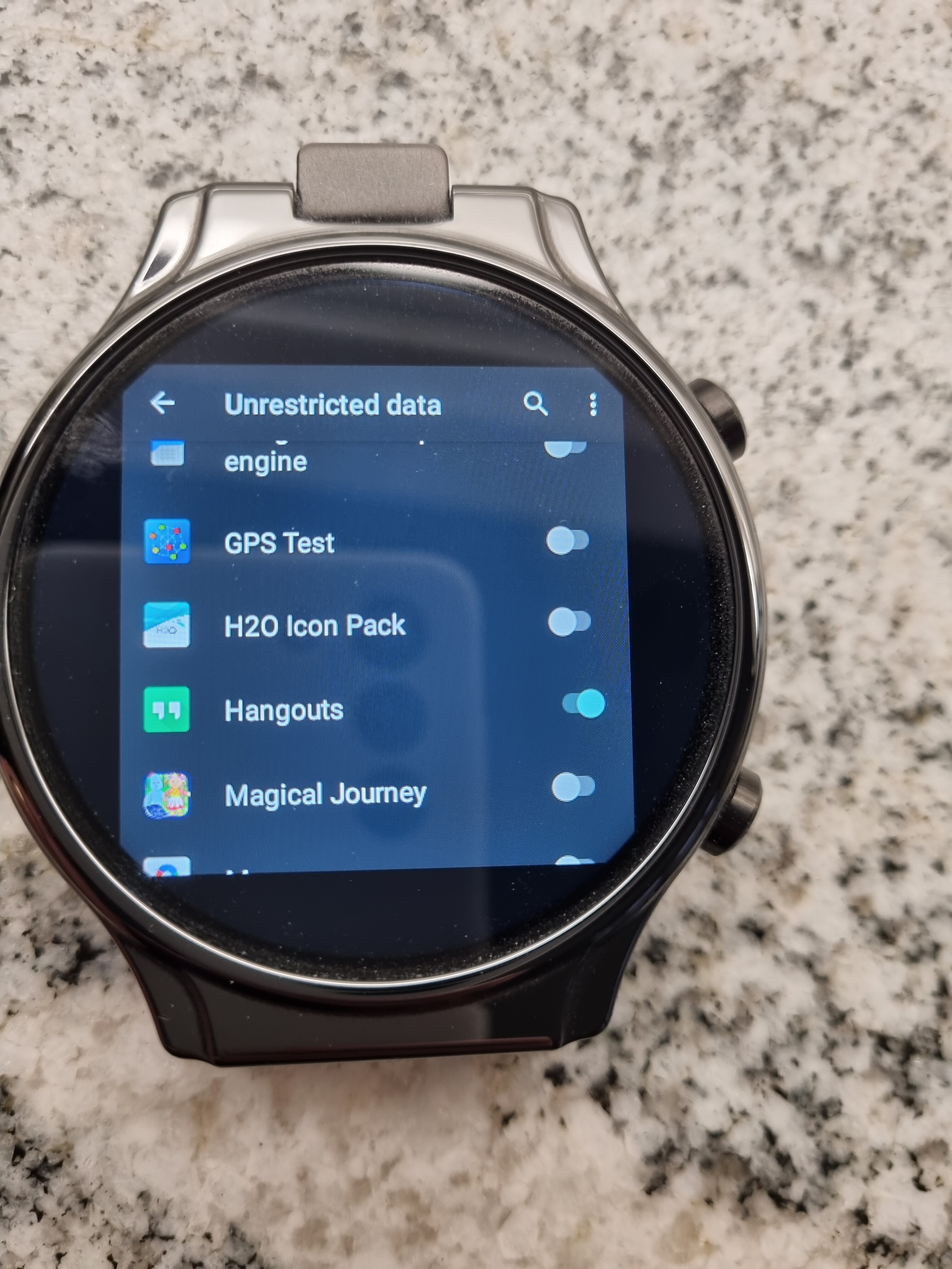

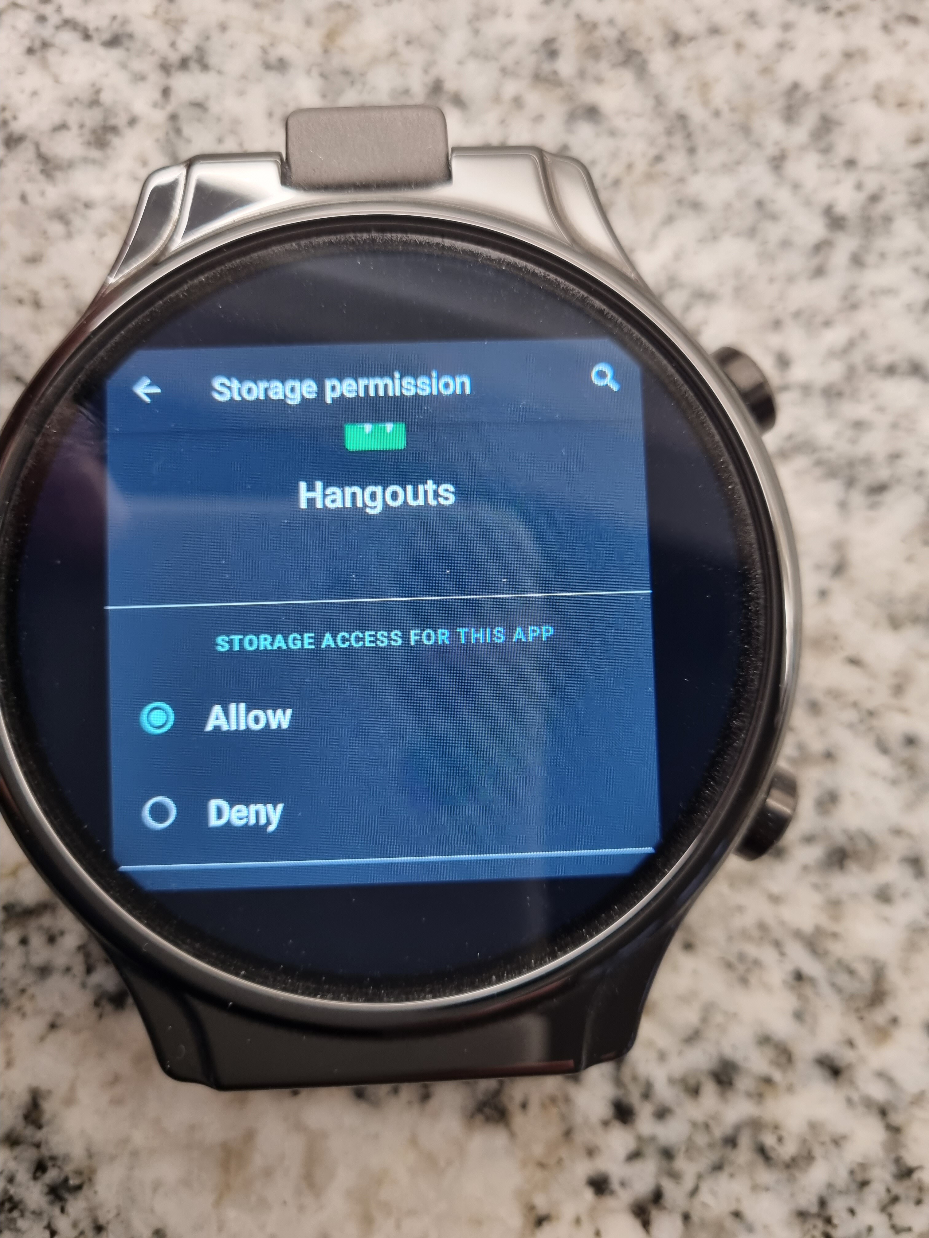

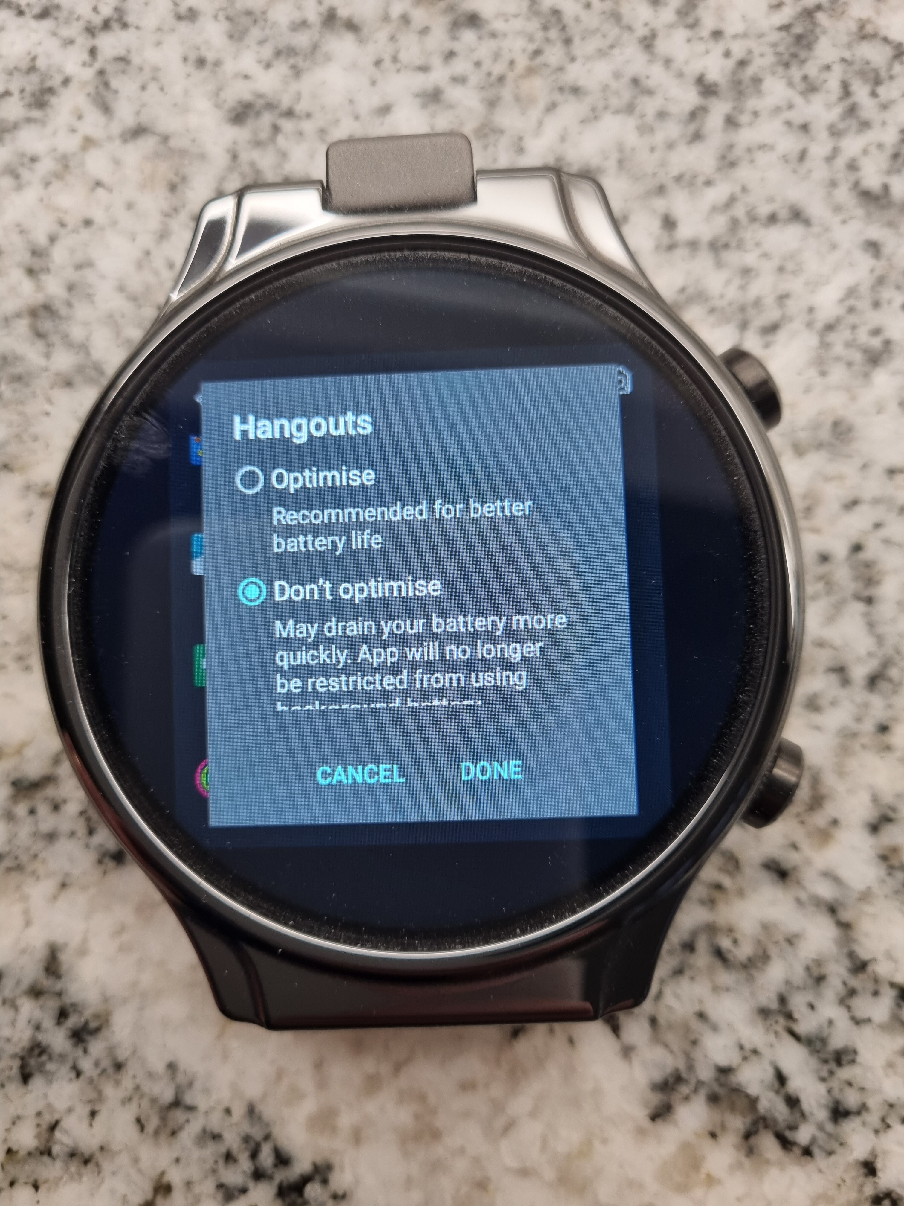

  1. Install the app from playstore.
  2. Turn Off Battery Optimization (not installed facebook, no need for hangouts). Not restriction in background too.
  3. Run the app. In Videocall, all permision has granted (Camera, microphone).

Will my battery have burned out after the rom change? This is my configuration to migrate the rom to the watch.
Aditionally after that, i did full restart and erase all data.
Uploading: 20210521_202004.jpg…
Uploading: 20210521_202028.jpg…
Uploading: 20210521_202103.jpg…
If after doing the above i have no idea why hangouts wont work . As for your battery . If after a full factory reset you have serious battery drain with nothing installed ( and you havent messed around with watch ) we have a problem
