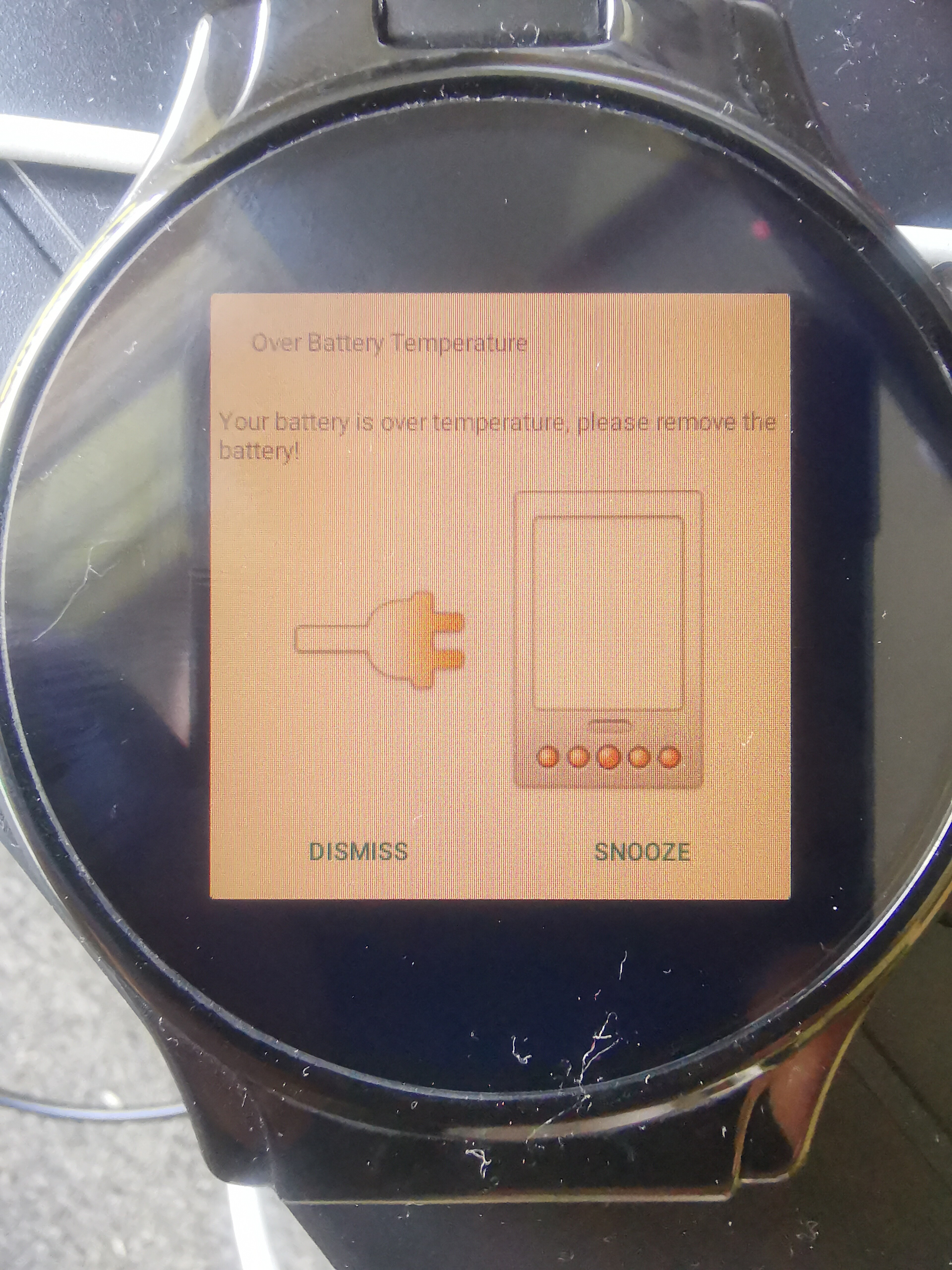

Regarding version 9.196.1 I noticed that battery life for my usage is better when in airplane mode with wifi enabled only. I was trying to force 3G but for some reason the watch was using 4G only. Switching to 2G is working although battery life is not as good as in airplane mode with wifi. Currently I also got a message regarding the overheating the battery during charging as on the attached photo
Quite a message there, “Please remove the battery”. How many will have the skills to do that and what about warranty…
That is just a generic user warning from a time where batteries were actually replaceable.
But now this app can be considered as legacy (and will be removed), it just warns the user if the battery charging is on halt because a certain temperature threshold was reached.
This is working as intended and can sometimes happen if the thermal strain is high on the system.
Just as an additional note:
Battery overheating is very unlikely, if a certain threshold is reached it will first stop the charging process, then throttles the system and if this doesn’t mitigate the situation it will just power off until the battery is cooled down.

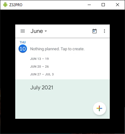

If you can tell me exactly what is needed i might be able to figure something out.

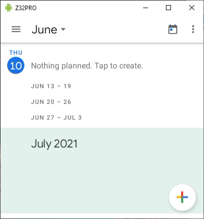

We currently have three factors that can be used to adjust the usability of applications:
- Fontsize.
- Density.
- Dimension.
The density is 140 for most apps:
With 160:
And 120:

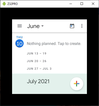

Dimension (or window size) with round/fullscreen:
And square mode:

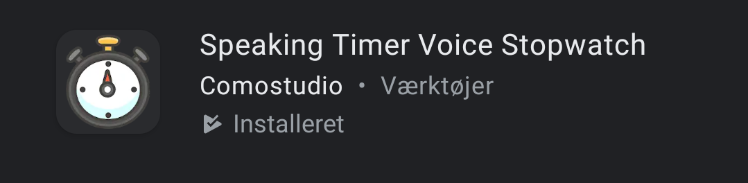

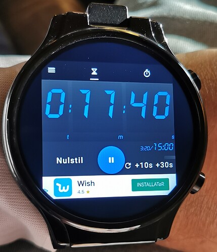

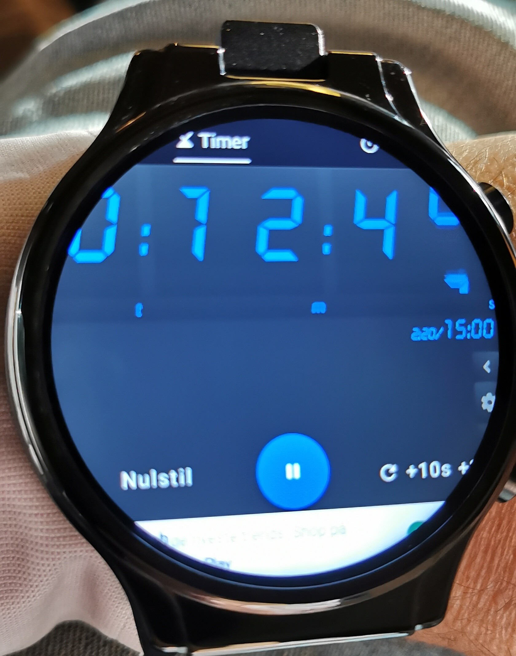

Wow, thank you. I wouldn’t know what it takes, but as you see, this app is either too small or outside screen area:
The app link is:
Perhaps you can better figure it out by trying it
