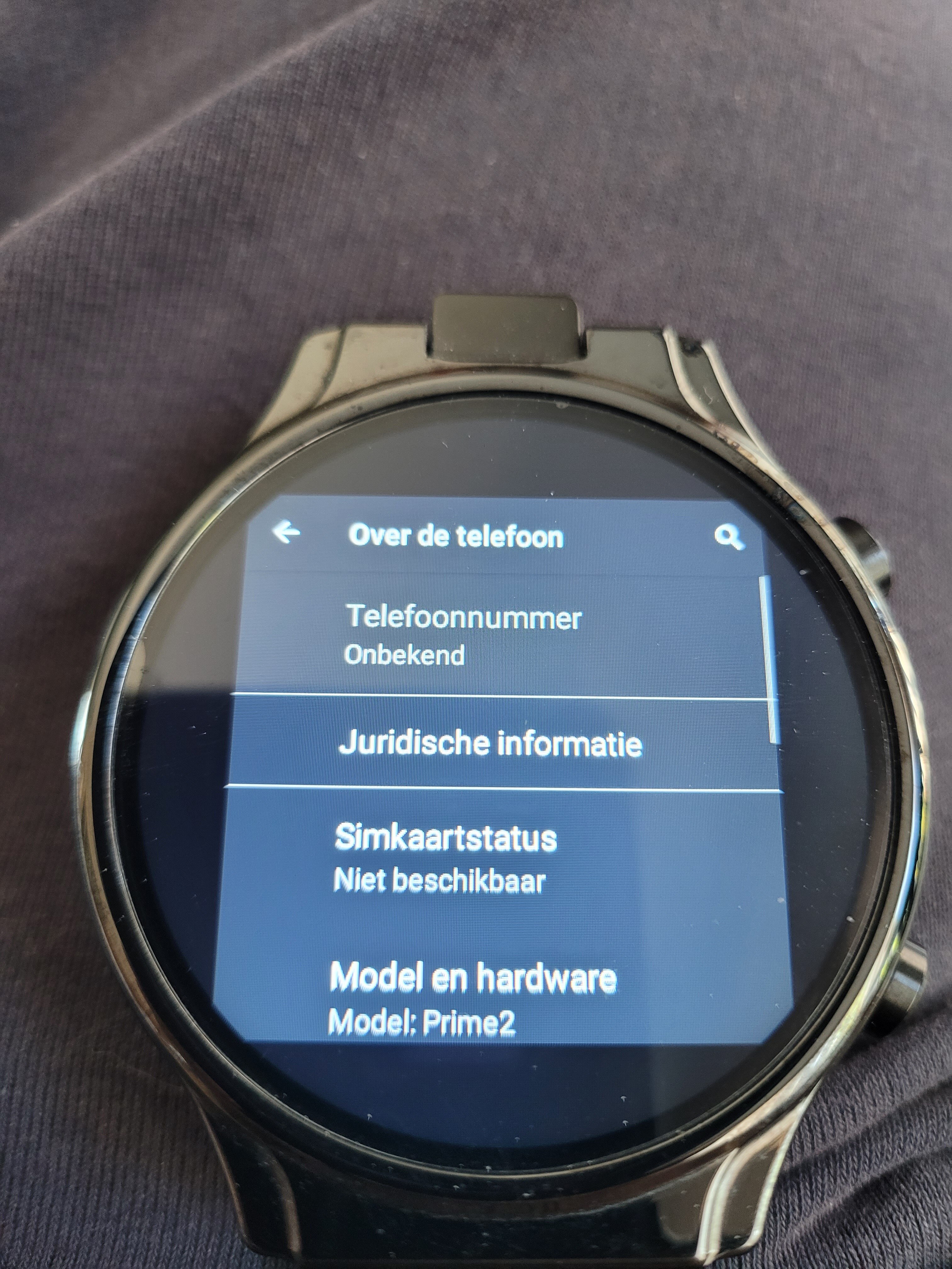

i am trying tu put v1.1 on my second prime2 wich is already on v1.0 when i go to About Watch i have no wireless update option…any ideas?
