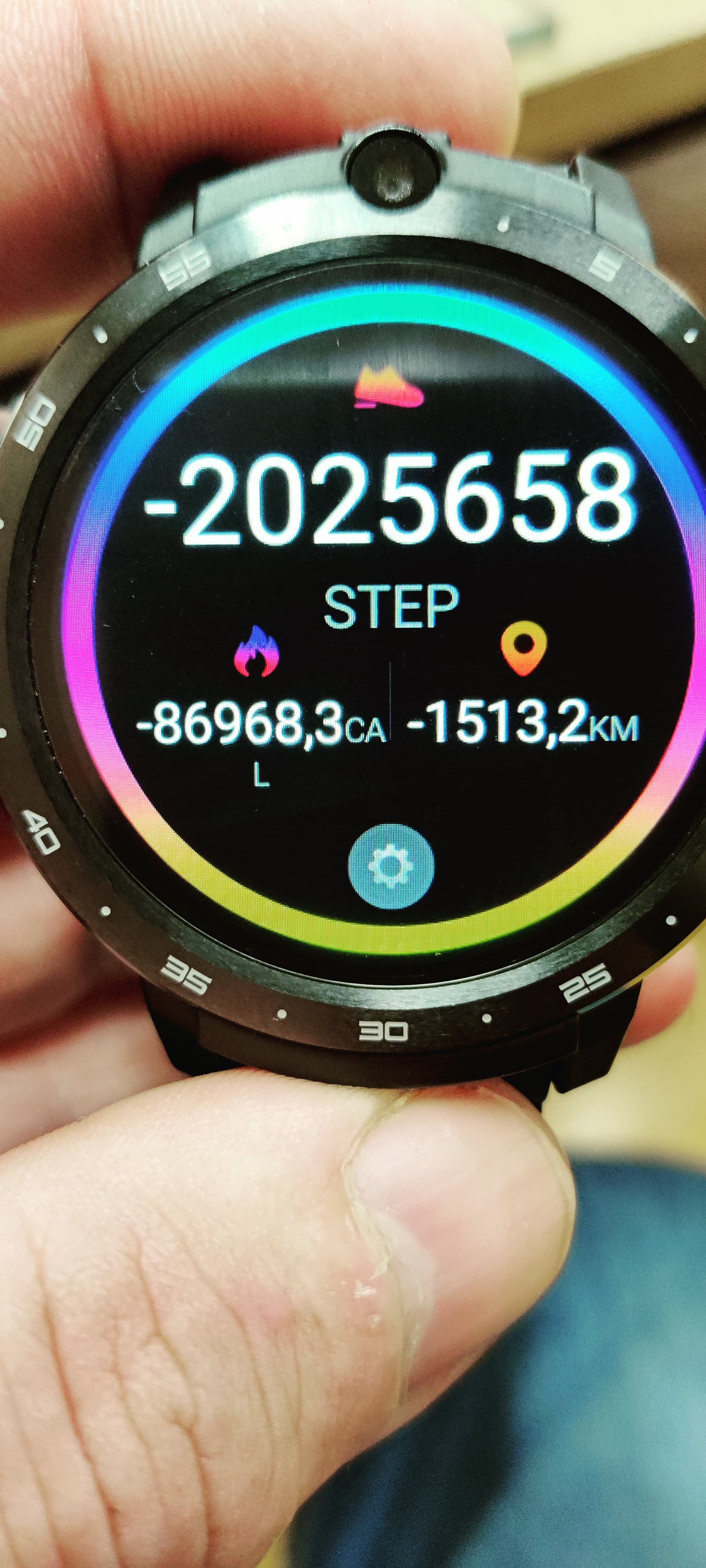

Anyone have any idea why my Kospet Prime 2 shows something like this?
20210907_141354
Firmware vesion: FAW_1.2
Yesterday I flash the stock firware D09_KOSPET_PRIME2_V1.4_20201031.zip, then FAW-PRIME2-V1.0.zip and finally FAW-PRIME2-V1.2.zip. After each upload, I performed a factory reset.
LEM12PRO FAW-V1.2.zip
From my observations (after factory reset):
  • up to 240 steps, everything works fine,
  • at step 241, the display showed -480 and after the next step -640
  • and the watch began to count down steps forward -639,-638 etc…
  • at step -480 counter jumped to -1497 and after one step to -2710 …
  • and again it counts down -2709, -2708 etc.
There is something devilish about it logic :slight_smile:
Do you go backwards or moonwalk alot? :joy:
I think I’ll start walking sideways, maybe it will help :wink:
The step counter logic has been altered for V1.3, so this is was a known issue on V1.2
