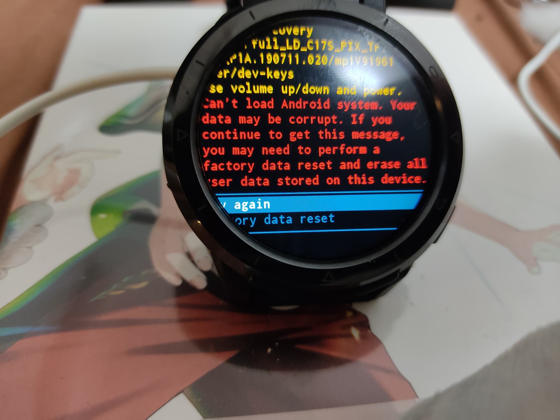

At Optimus2 with FAW firmware V1.2RC1 (factory reseted, some apps installed), OS was crashed. And I got the message as below:
I guess this message means factory reset is needed, and some apps made this accident. What can I do for report? I will check without apps tomorrow.

Thanks for the reference, it is caused by the pixart chip that reads the sensor data from the accelerometer.
Updated the release candidate build for the Optimus 2:
  • Fixed an issue with the pixart sensor readout.
  • Updated pixart firmware.
