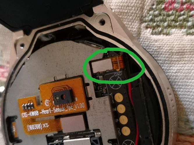

I MADE A BIG MISTAKE !!! CAN SOMEONE HELP ME
I got a brand new Thor Pro today and i have been so deep in my Routine that i opened the Back (!) to set in my SIM-Card ! What a Fool i was ! So the Battery came out quite fast and i cannot remmber the correct Position of it … There is a tiny Cable for the Power Connection, but where is the Point inside the Watch to put it back Please anyone, help me.
The Slot for the SIM-Card is on the left Side, yeah i know that now. Shame on me
May 17, 2018 18:47:25 GMT 1 kelly63 said:
I MADE A BIG MISTAKE !!! CAN SOMEONE HELP ME I got a brand new Thor Pro today and i have been so deep in my Routine that i opened the Back (!) to set in my SIM-Card ! What a Fool i was ! So the Battery came out quite fast and i cannot remmber the correct Position of it ... There is a tiny Cable for the Power Connection, but where is the Point inside the Watch to put it back Please anyone, help me.
Without being able to see the watch I can’t be sure but here is what I would try. Plug in the cable to your charging base. Using a volt meter determine which pin of the four is + and which is - (just for confirmation). Then once you know the positive pin follow it to the battery mount and that would be the positive end. Always read the manual.
upload pictures so we can see and help:)
how it look with the big screen, i just bought one usually all those watches has the same hardware inside look for youtube videos
Attached is a photo of what the connection should look like. Hopefully it will be the same as this because it is made by the same people who make the pcb for the Thor 4 and LEM7.
It is almost always the little flat, rectangular tab connector on all watches.
If you get a magnifying glass you should be able able to see tiny markings on the pcb as well - where the socket is.
