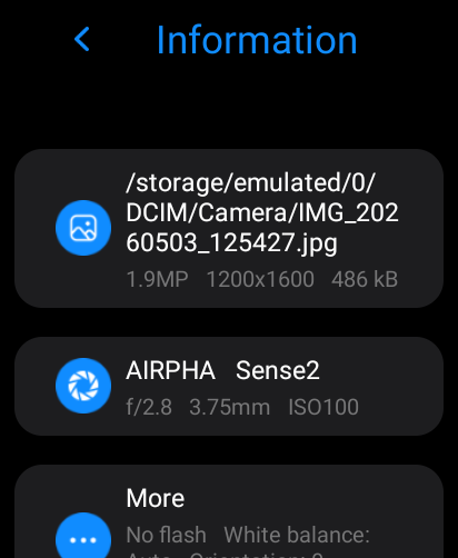

  2. the camera is 2mp, the best i’ve seen on these unisoc watches

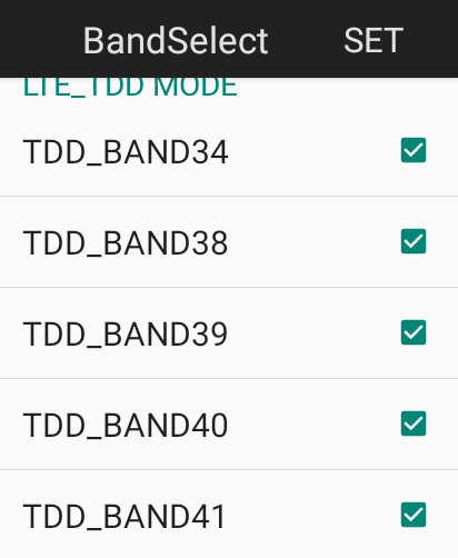

  4. my CD20 has FDD-LTE band 20, but the CD20max doesn’t, despite the pamphlet which came with the watch saying it does !
and while there are other LTE bands on the watch, and used in europe, (UK in my case), it seems band 20 is the most crucial and widely used, which might account for the difficulties being reported by other users, i live in an area of poor reception, so this is a deal breaker for me
i’d be interested to know if anybody with a chinese version has band 20 for LTE ?

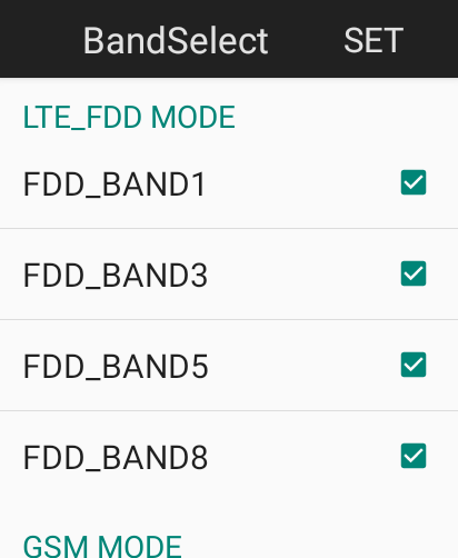

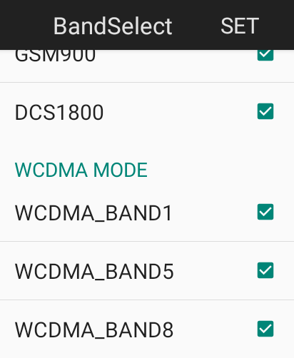

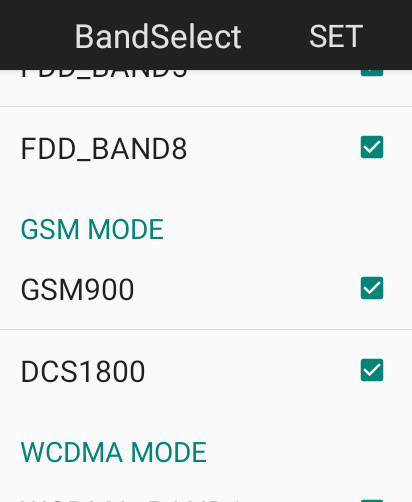

From my CD20max CN version (2026):
thanks for that, i suspected as much, the unisoc website is a bit cagey about the supported bands, just referring to ‘full netcom’ (which i think equals china unicom), which of course does not use band 20 like europe does, so i’d have to conclude these W527 watches are crippled in europe, unless you spend virtually all your time in areas of good coverage of course !
the W377E is fine, which makes you wonder why they dropped band 20 in the markedly better chip !

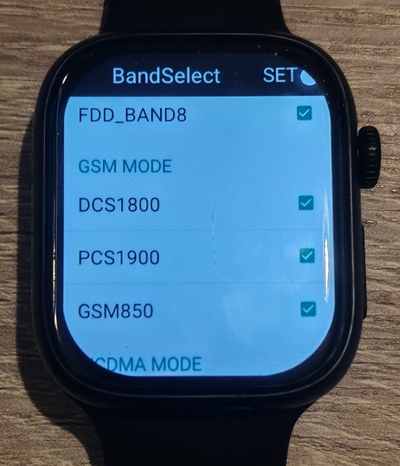

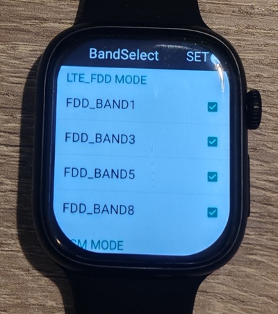

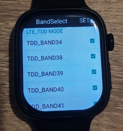

i have w527 global NV, i will update if there are more band available.
i have w527 nv for 2,3,4,5,7,12,25,28
no 20 unfortunately in both NV i have
What is the code to bring up this menu?
It’s AI LIFE’s Developer helper app: AI LIFE / DW smartwatch developer helper · GitLab
Telephony | BandSelect
you can also use tasker, it’s simply selecting the ‘engineering mode’ app from the run list
