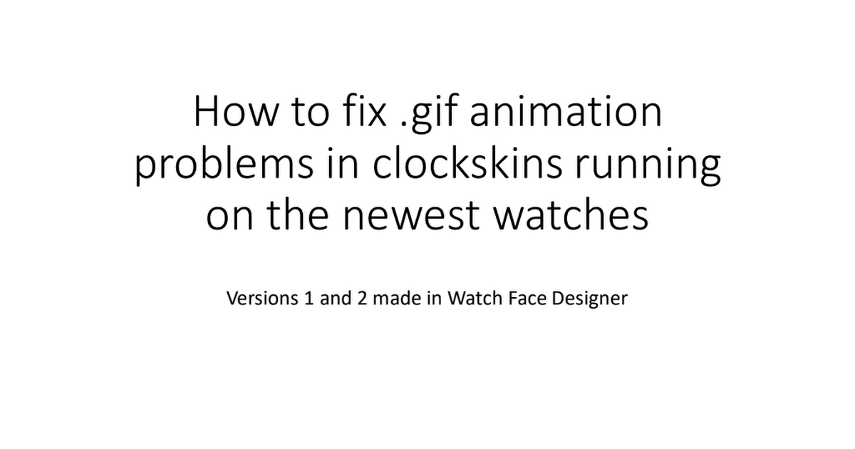

@teatimesoon … You can use various images and load them into WFD.
I believe the below is a link @Dr_Andy_Vishnu has shared before. It explains how to correct gif animations in wfd via editing the clockskin/xml file (once you have loaded the image in WFD) and saved out the clockskin file.
Hope this helps a bit.
