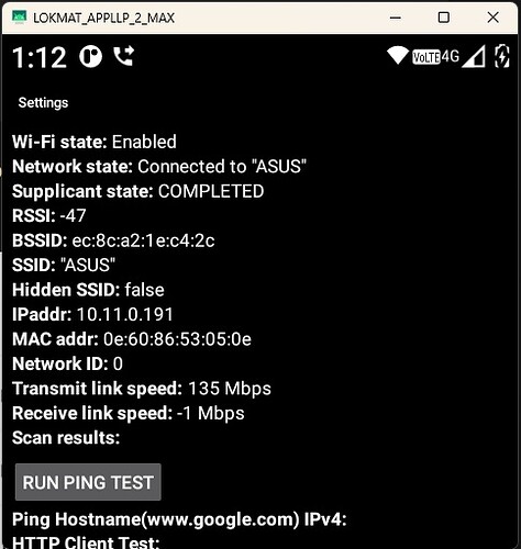

Some initial testing shows that it really does support VoLTE calls.
No engineering app needed, just use dialer code star # star #4636# star # star and select LTE only.
Then - and this is important - go and update Google Play serives by going to Settings, About Watch and click on the “Android Version” bar.
You will get the real Android 11 setings app and it allows you to update Google - you can see I have updated mine today:
I advise you to set your preferred country in the radio selection options.
You access this by using the code in the dialer again and click on the small 3 dot menu at the top right of the screen:
Some other interesting stuff for now - also that we can finally connect to a 5ghz Wi-Fi system - for real :slight_smile:
And Hardware info plus pdf attached.
