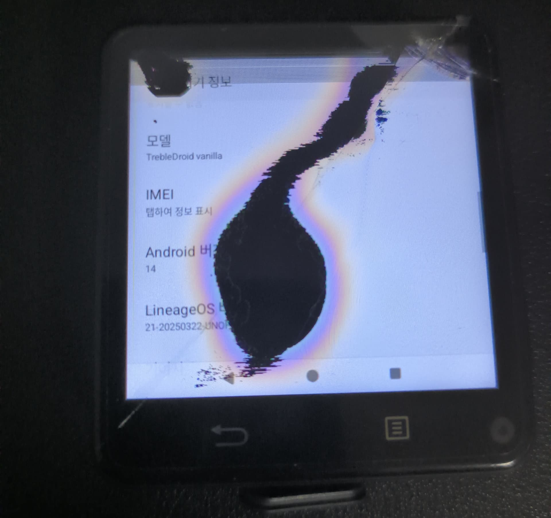

I successfully flashed lineage os gsi.
I did it! (and I know, it’s a crazy trial
I did this becase, as a picture, mine is broken.
It’s not a software issue. ![]()

How did you flash It? Thanks
bootloader unlock using mtkclient.
flash gsi with hovatec instruction.
you should google and dig, drill how to do it.
I strongly recommend that you don’t try this.
There is absolutely no chance of flashing back to the stock firmware back to the watch if something goes wrong.
It is not available and is not supported.
GSI firmware exist for this watch and is available on the net with tutorial to do that… Not supported and available on this forum is the correct answer. ![]()
It would be better a DM100 with his firmware and magisk? I want a root watch
