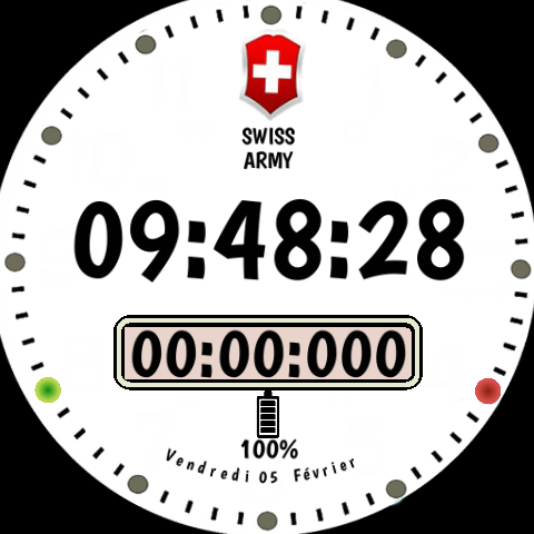

I have another strange behavior in UL on Prime 2 or Prime :
Curved text that shows nicely on one page but refuses to show on the second page if I was on the first page when I switched to this watchface :

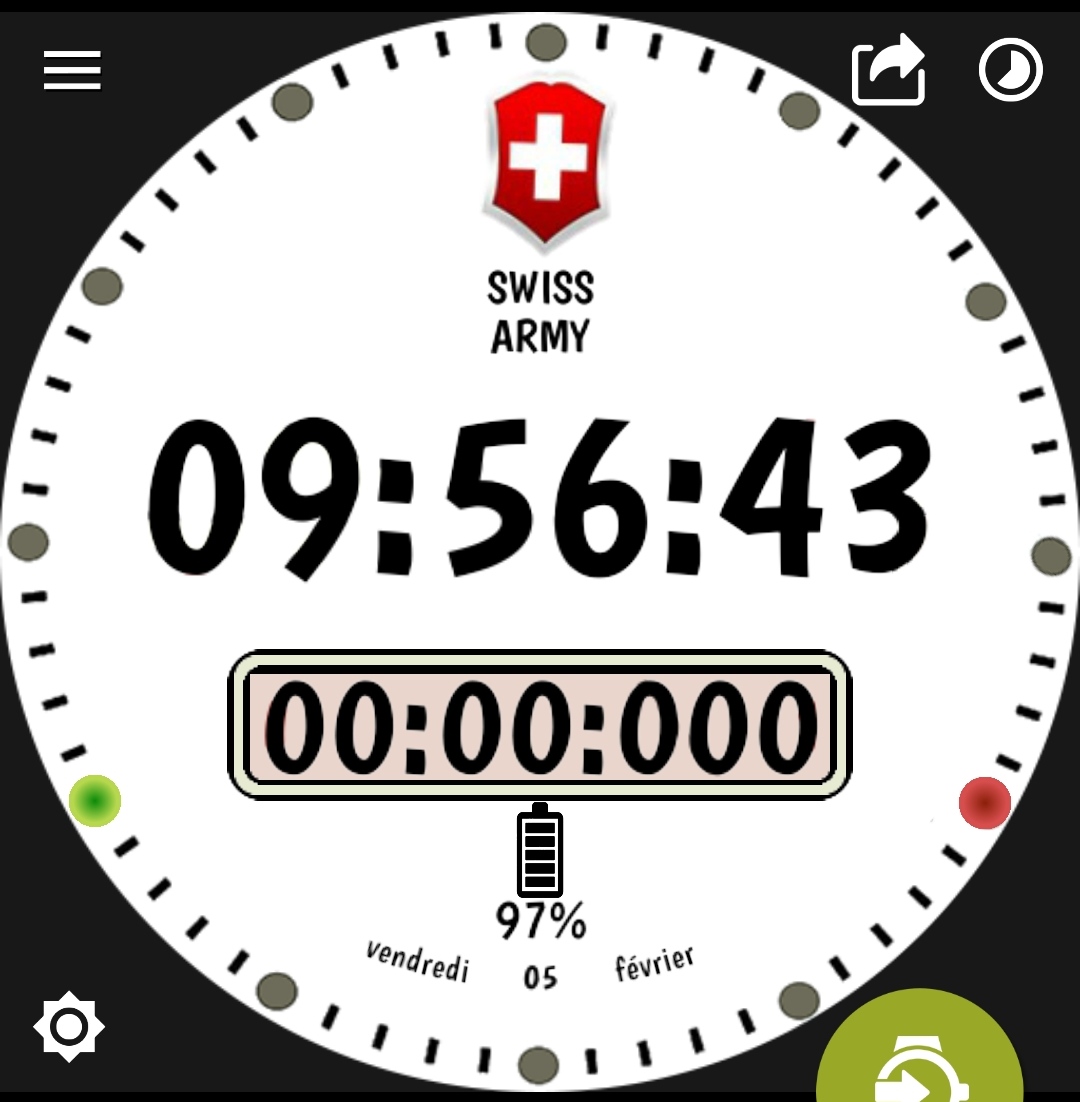

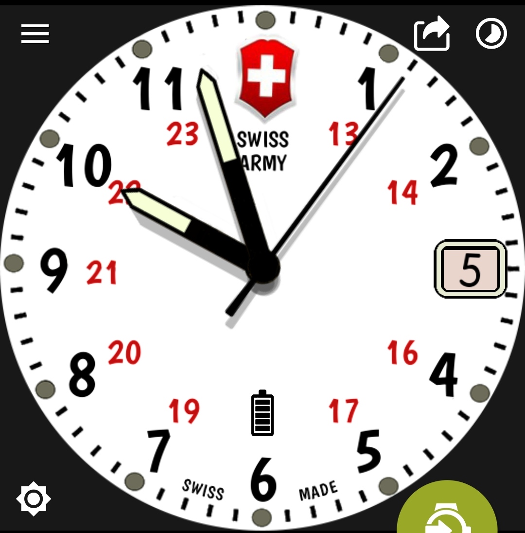

Those are the real ones on WM :

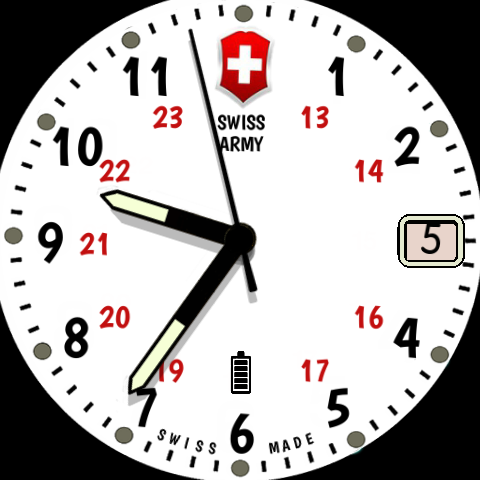

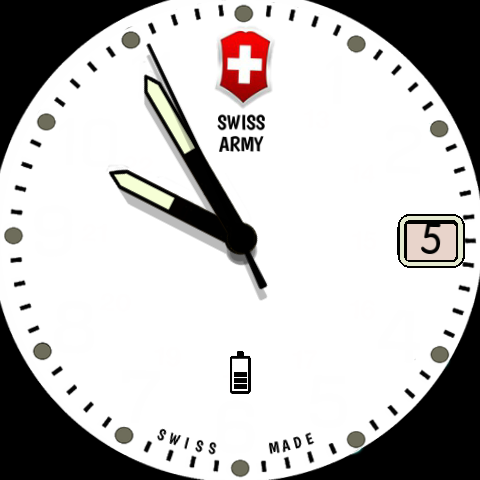

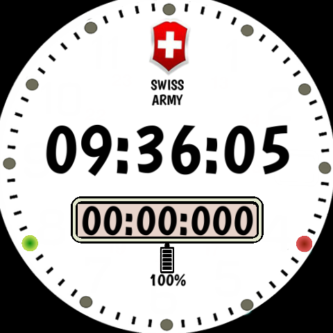

But, if I switch to the second page and then change watchface to come back to this watchface, I get this :
This time the curved text on the second page shows correctly and the curved text on the first page is still here.
If I go back to page one again, switch watchface and come back the curved text on page one is still here but the curved text on page two has vanished!

If I load the watchface from the second page the first page has several layers missing!
The black and red hours numbers are goneā¦
