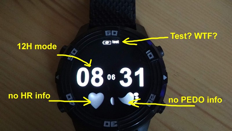

I had 2.5.7 version on my Lem6. It worked without serious problems but it hangs after turning Lem6 off because of battery exchastion. It shows battery status level with "test" text in place of "%" and clock in 12h mode even if skin was prepared in 24h mode. So I decided do upgrade it to 2.5.9. I instaled new version, but couldn't launch it from "Open" button after instalation. I used "Done" and Launcher app disappeared form standard apps list. I removed it completly and made clean install of 2.5.9. It started but I cant change watchskin - nothing happens after selecting of new face. Now I tried to change "skin prefs" and Lem6 switched on default launcher automaticaly.

“test” usually means that the skin has not been initialized succesfully, so something in it is not supported. Just use another one.
Ang give me the link to this face so that i can look.

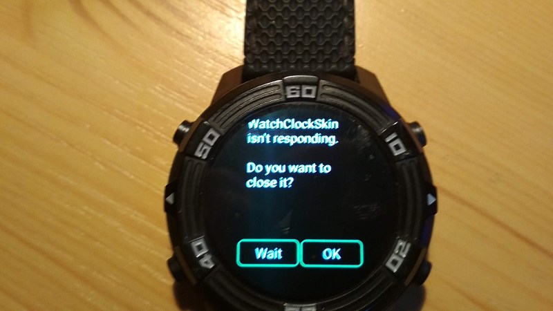

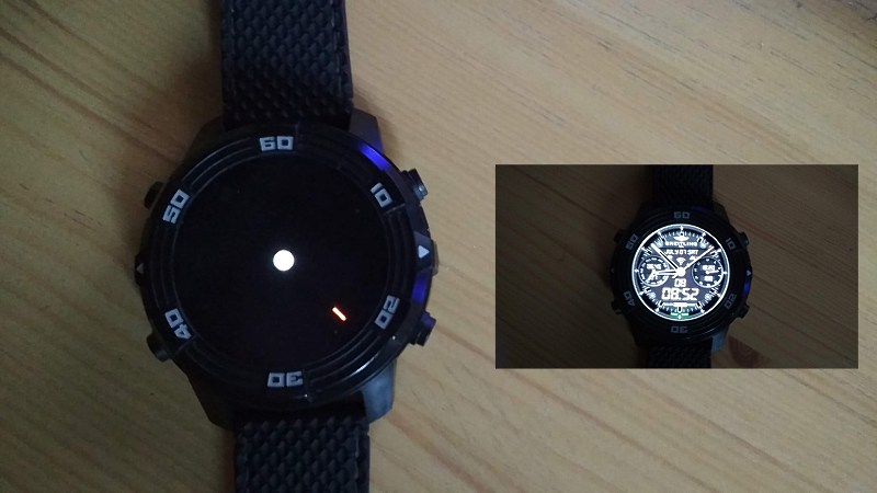

I had to exit Launcher (leaving it as permanent launcher). Changed skin on Breitling and here you have effect after another reboot:
All I see is dot and end of seconds hand. In meanwile, Launcher hangs for a first time, giving such info screen:
