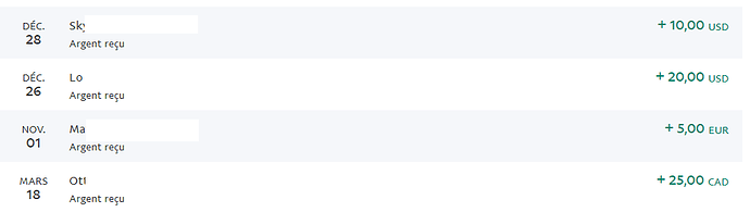

By the way, for those wandeing, here is a little sum up of the donations i received this year.
Thanks to all donators !
