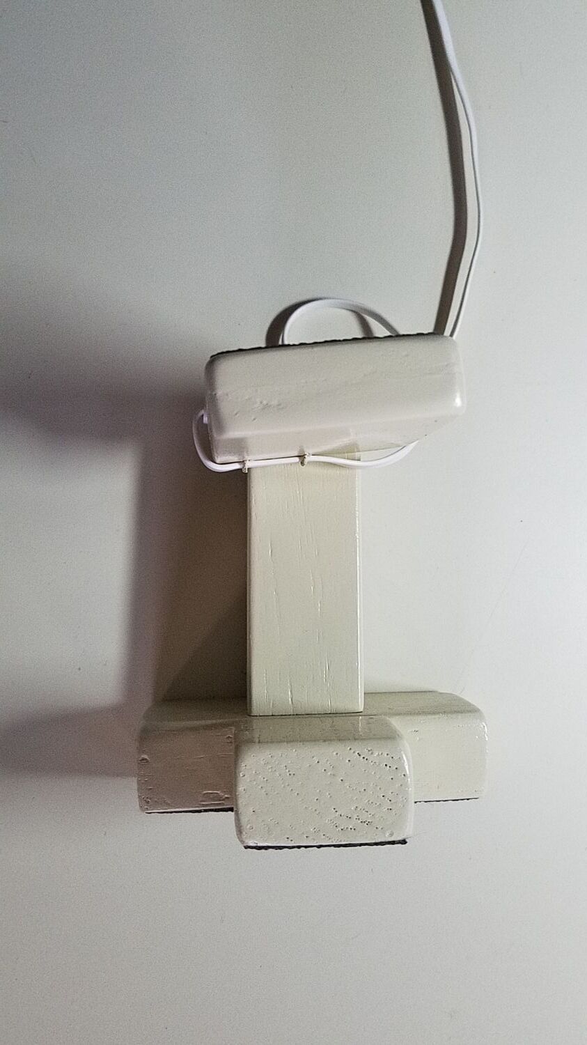

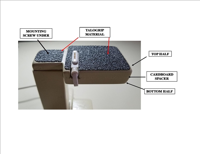

Another answer to this problem I build a simple stand, using the supplied cable,  that works for both my I4 Air and H2 because they use the same cable and the contacts position is the same on both watches. The weight of the watch keeps the connection secure. You just place the watch on the stand and walk away. Note: the height of the cable in the stand is important. If too high the watch will not lay flat, if too low it will not make good contact. A slight angle of the platform helps in good positioning.
Hello!
captjon,  what kind of material did you use to build the stand, which you show in the pictures? Is it wood?
How many pieces are needed to build it?
Can you please, show an image of how it looks, when placed on a table, for example?
It is very interesting and I am able to try to reproduce something similar if I know how it is done.
Thank you for your help!

It is built of wood because it is easy to work with. I used 5 pieces total, of wood scraps I had available to work with. There are two pieces that form the base or you could use one piece if it was large enough to provide support so that it would not tip over. Three the pedestal and two more pieces that form the platform where the watch rests. The pedestal needs to be long enough so that with the watch band closed in one of the last holes it will not rest near the base. The platform was the only part that required a bit of work. I used two pieces of 1/4" thick pieces sandwiched together to make the opening for the cable to mount. The top piece also provides the attaching point for the platform to attach to the pedestal with a screw, that is located under the “Talogrip” material. A thick piece of cardboard was glued between the two pieces to give the cable the correct height to match up to the watch so it sits level on the platform and the contacts mate correctly. By doing it this way I only had to get the opening for the cable correct for the top piece and it is glued to the bottom piece. Note I added a slight angle to the platform for easier positioning.
Thank you very much, captjon
Great job and very good explanation!
The “Talogrip” material is good, not only to prevent the smartwatch from slipping, but also serves to protect it from scratches. Very well thought out!
I’ll try to get the material I need, to do something similar for me.
Many thanks, once again, and Congratulations on the good work!

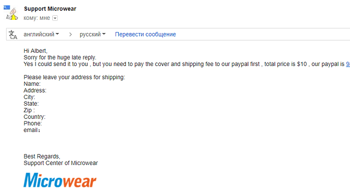

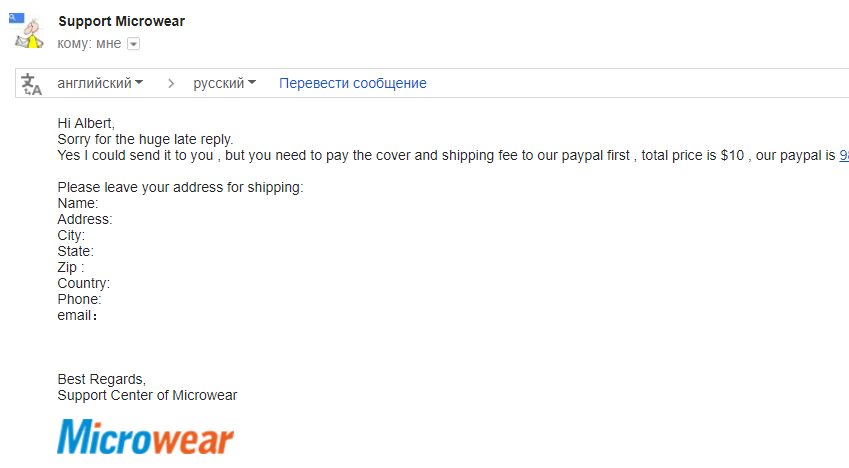

I asked this seller about the lid. The seller found such a lid, but asks for a price of 28.68$ for a regular piece of plastic that is fragile and not quality.
P/S
I got a response from the official manufacturer of this watch. I wrote to him the first time I wrote to Aliexpress.
They told me that the lid, along with the delivery to me, would cost 10$.
Scammers out there, on AliExpress!

I wrote directly to the official website of the manufacturer, to the support service. And they wrote me the answer.
