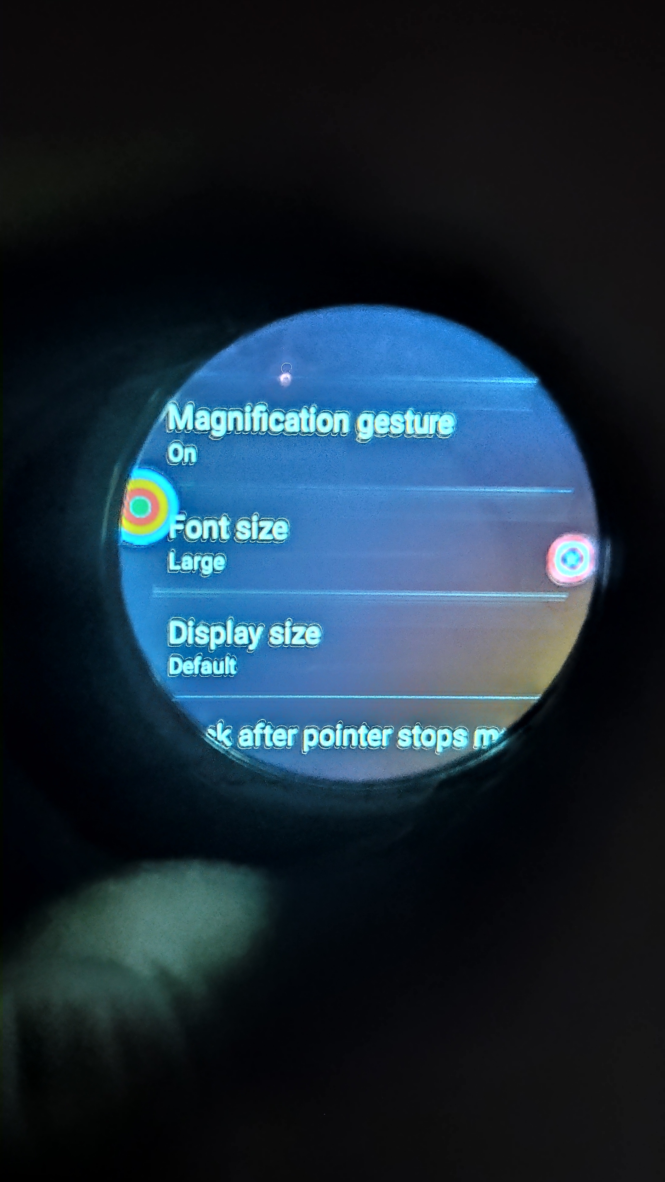

I ran into this issue on my watch it has to do with in your accessibility settings your display size needs to be taken to a smaller size, on mine I ended up turning the display up to a larger size but it made it so that some of the buttons were off the edges of the screen and not usable so had to adjust it smaller
Thanks… That might be it.

Also the Font Size can effect screen visibility. I don’t normally change display size but do enlarge font size. So sometimes I have to reduce it back to see the whole screen.
Yes. Very true @Jonathan_Bickel

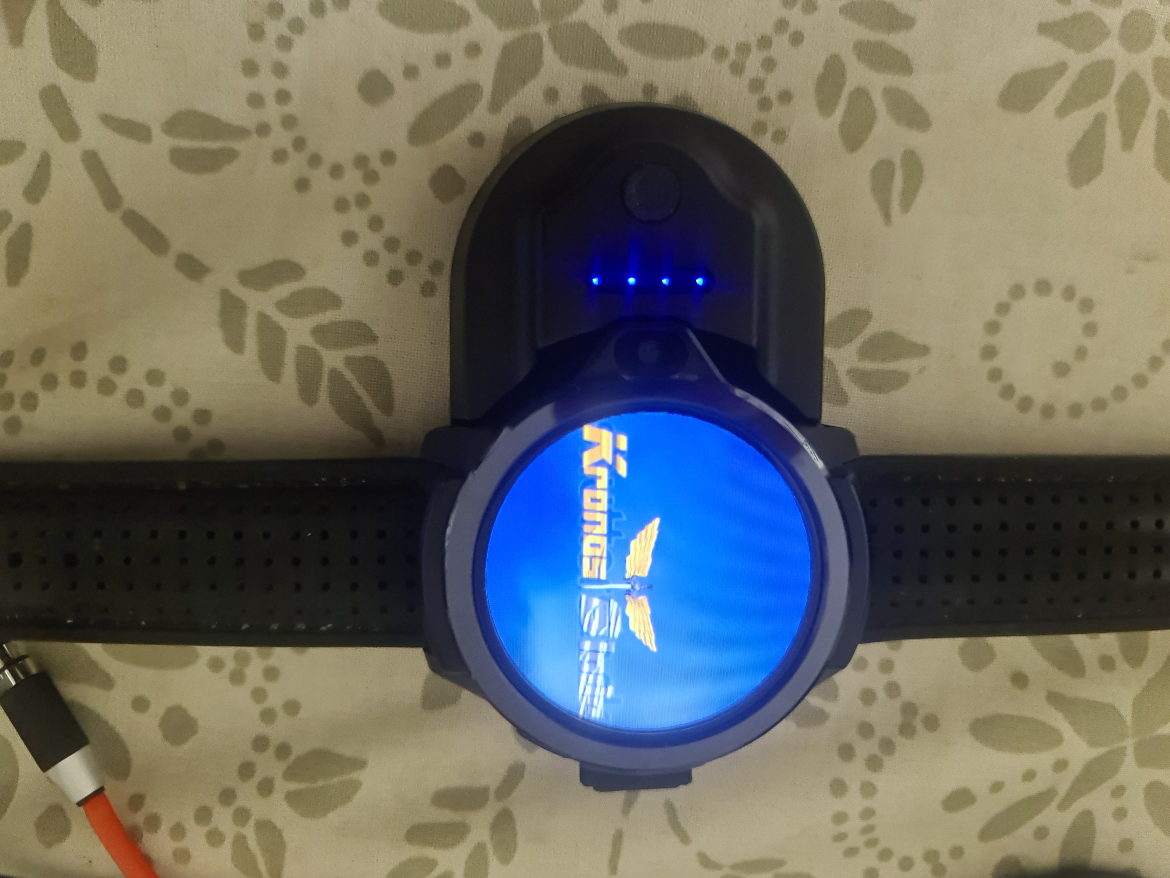

The issue with my Genesis is right now, that I can not turn the watch on.
I tried with both my wrist chargers and both socket chargers, so I have tried 4 different chargers.
I tried holding both buttons in for over 1 minute. Nothing happens.
Sometimes I see the battery sign, then the Kronos logo and then the wrist charger stops and the display goes dark again.
I have uploaded the 3 pics, that shows you, what I am seeing
@smile2lee yes I see.
Can you try and use the independent USB cable that connects directly to the watch. No charging dock.
See what happens then when you connect the USB cable to a laptop or PC.
If the watch powers on in any of these situations - please power it off again and monitor the charging.
The other thing I notice is that in all pictures you don’t have the USB power cable attached to your charging dock.
Have you tried using the charging dock with the USB power cable plugged in to both a power source and the dock?
As I said before, we will work though each step one by one and see what happens.
Cheers.
Yes, I have tried with my USB cable attached to the wrist dock and yes I have tried connecting directly to the watch with the independent USB cable to different power sources.
Now I tried to use the USB cable to my both my laptops (private and work) and on my private laptop I got the red battery again og the display went dark again. I also tried different PC USB ports.
Yesterday I also tried with tons of different powerbanks, I have.
Still no continueing charging on watch.
@smile2lee Ok, one more thing.
Can you connect the watch to a laptop or PC with the “direct attach” USB cable and leave it for a few hours please?
Then update us with the results afterwards.
We are looking for this:
a) is it warm to touch?
b) has it taken any charge at all?
All the information get is extremely important.
Thanks.
