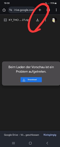

This is the only firmware I found. But I can not guarantee that it’s the right one for your watch. But in my opinion it’s a “shot for nothing”…
-KY_THOR5_20200727.zip - Google Drive

@Muhammed_Karakayış To download the firmware, ignore the hint and click on the download icon:
