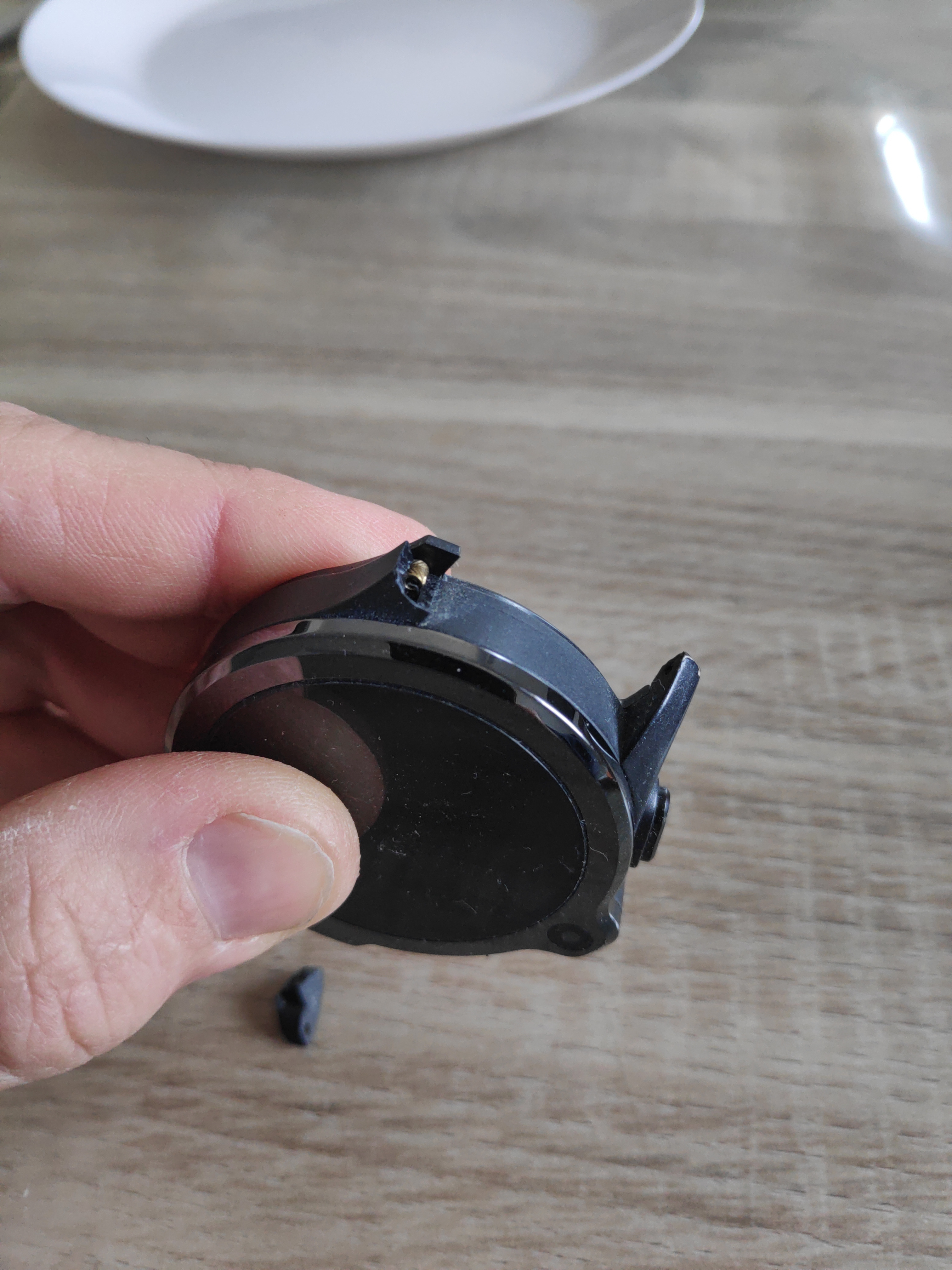

I own both the Optimus Pro and Prime. While I’m very happy with the Prime, be aware of my experience with the Optimus Pro falling apart after just under 6 weeks of usage. It appears to be a hardware material failure as I woke up one morning, the band was detached, and the corner of the body (lug) was laying in my bed. I want to be clear that my watch has not been under any physical duress, in fact I am extremely careful about protecting it.
I sent an email to Customer Service and they indicated that I should reach out to Bangood. Obviously a major flaw by the manufacturer, not Bangood.
I would like to concur with ‘eswiderski’ The exact thing happened to my new Optimus pro only two months old. The plastic casing cracked and broke near the strap housing the same as the above photo. Fortunately I managed to buy a secondhand Optimus pro for spares. Only yesterday I managed to swap the casing over. (Aprox repair/swap about a half an hour.) It was much easier to do than I thought it would be but that’s not the point. It’s a real shame that many are and will be, left in this position. I am sure a few people were shocked like myself after purchasing this, to find the material of the casing is of brittle plastic and certainly not suitable or strong enough for holding watch straps in my opinion. My next watch phone will be with a metal casing.
Just a note, I will also attempt to glue and reinforce the broken plastic casing and keep it as a spare because I have very little confidence that my new watch casing will last very long either. If I feel that I have succeeded to do a reasonable job, I will post the results on here to explain how I did it and with what materials I used. Perhaps it may help others that may otherwise end up throwing the damaged watch/case, in the bin like I was tempted to do myself.
I would also like to add that I tried contacting Kosfet by email a week ago and still waiting to get a reply.
Thanks to all, Jake.

Hi cosmicma I am glad that your watch has been okay and no problems. It may be the case that some of us wear the watch with tighter straps but I would have expected the materials used to be able to handle this. We will see how long my new replaced watch casing lasts. However I love the device and have had great fun with it but am very disappointed with the material quality of the casing.
The screws used are very low quality and highly susceptible to rust from the salt in our sweat. In conjunction with the weak plastic body, the result is as above.

Suggested way to repair fractured or broken watch case.
My suggestions on a way to repair damaged casing. In my case and a few other peoples cases the lug broke on the case which holds the strap on.
It’s my guess that holes were drilled and then a screw sleeve plug is inserted during manufacture and when inserted slightly compromises/fractures the body on the inside, the area where the straps are held on gets slightly fractured causing this to be a week point. Which may explain why some people as yet are not having this problem. (note) There were no signs of corrosion or reaction noted from the screws as been suggested in other posts)
This repair idea assumes that you still have the two pieces of the broken object.
Because there is very little meat at this point of where the fracture is. It seems that they always break in the same place and this is the weakest part because there is a brass screw plug inserted at this point. I decided to glue the two pieces together using JB Weld product (Original ) a two pack epoxy resin based adhesive which has metal fibre reinforcement. (it would have been great to have reinforced the joint with something like pins but would have been very difficult because there is a screw sleeve right in the way where it broke))The first stage was to prepare the two parts for glueing using a procedure similar to what a dentist would do if filling a hole in your tooth or inserting a cap. I used a dremel tool to try to make a sort cavity in the two pieces to try to create a decent fix for the adhesive to bond to and also roughing up the joint faces with the dremel tool. Then I cleaned the area very carefully using isopropyl alcohol with a fine paint brush. When using this you must be very careful not to get any or even a drop on the front face of the plastic because this will eat in and leave a mark. Possibly a good idea to mask the face area first. I find that this is good to use as a prep because is slightly softens and cleans the face of the ABS and creates good surface for when applying the adhesive. The epoxy adhesive that I used was a very slow setting type and takes at least 4-5 hours to set and at least 15 hours to cure depending on the temperature of the room. The two parts are mixed together at a 1to1 ratio. Although more difficult to use than quick setting epoxy resin, this is the strongest that you can get when cured. The glueing and holding in to position was quite straight forward and by all accounts should hopefully do the job.
As an addition, this may be a bit over the top, but I also decided to reinforce the repaired lug with a peace of metal plate. Probably not needed but I did it either way. I carefully filed the shape of a this thin aluminium plate and pre painted one side with black paint. I roughed up the surface on the plastic surface and glued it in place using the epoxy resin. This way I am not totally relying on the repaired joint to hold. See photos. Of course the idea is to make the repair as unobtrusive as possible. Never going to be perfect but makes the watch still usable until one can source a replacement casing or a replacement device at a later date if need be. When wearing the watch the repair is not really noticeable in my opinion.
I hope that this may help someone in the event that they want or need to try to permanently or temporarily fix their broken casing on their watch phone to at least make it possible to wear again.

mine decided to snap a lug off but the good news is iv’e managed to fix it
i used loctite 3090 which is not the cheapest glue on the market at £20 a tube but it’s the best i have come across for gluing plastic and so far it seems like a strong bond
if it holds it works out as a cheap fix
Hi ‘Cosmicma’, just curious, did yours break in the same place as mine and the others on here?
it’s snapped in more or less the same position but a different lug
on the pictures posted in this thread it seems the same lug has snapped on all the watches ( top right above the button ) the lug that has snapped on mine is the top left but i wear my watch on my right wrist which effectively makes the lug the top outer facing lug the same as if i was wearing the watch on my left wrist if you follow what i mean by that
Yes I understand. It’s a real shame, there is a fundamental floor with this construction in my opinion. Please let us know how your repair lasts and will you still be wearing your repaired device for everyday use? My repair seems to be holding up but of course I have not been wearing it constantly, I may just start doing that.

I everybody.
This is my turn on my kospet Prime.
Two corners are broken
One fall and an other have stress sign.
I’ve this watch since a year and Wear it everyday at work and sports activities.
I take care of it but it was made to be weared a not just for the pleasur of the eyes.
I will try to repear it.
Interesting, seems basically the same failure point (at the brass fittings) like we have seen on the Optimus Pro.
