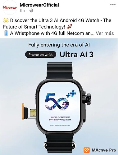

Microwear Ultra AI 3
Any information about this new smartwatch?
I cant find more information even in the microwear site
Nope, sorry.
It’s not one that we would support.
I bet the camera is awesome :joy::joy:
