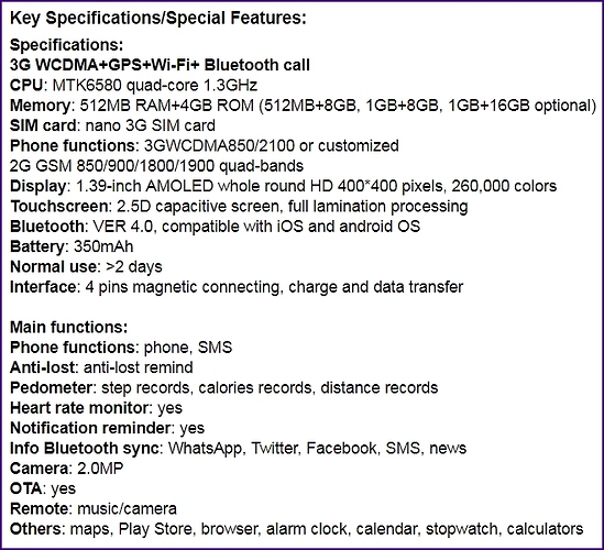

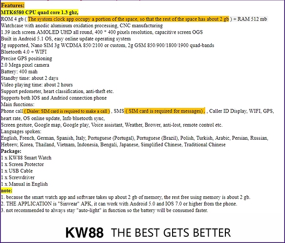

I understand the KW88 is a great watch. Almost bought one but went with the I4Air instead. But I was again curious so I went to Ali-Express to view the KW88 again as I understood it did not have BT call. Their listing even highlights that a Sim Card is required to make a call or send a text.
Decided to check KingWearâs web site and it does not show a BT call function for the KW88.
I have also noted on Ali-Express that they have what I call vendors on their site that sell the same product. Some of the product information on the watches is not the same between vendors, often containing errors. So I carefully research a product, off site, before buying it on Ail-Express.

I checked the auction I bought it and youâre right, it says SIM card needed. Anyway I also remember reading some forums where it was said that after fw updAte Bluetooth calling is available.
