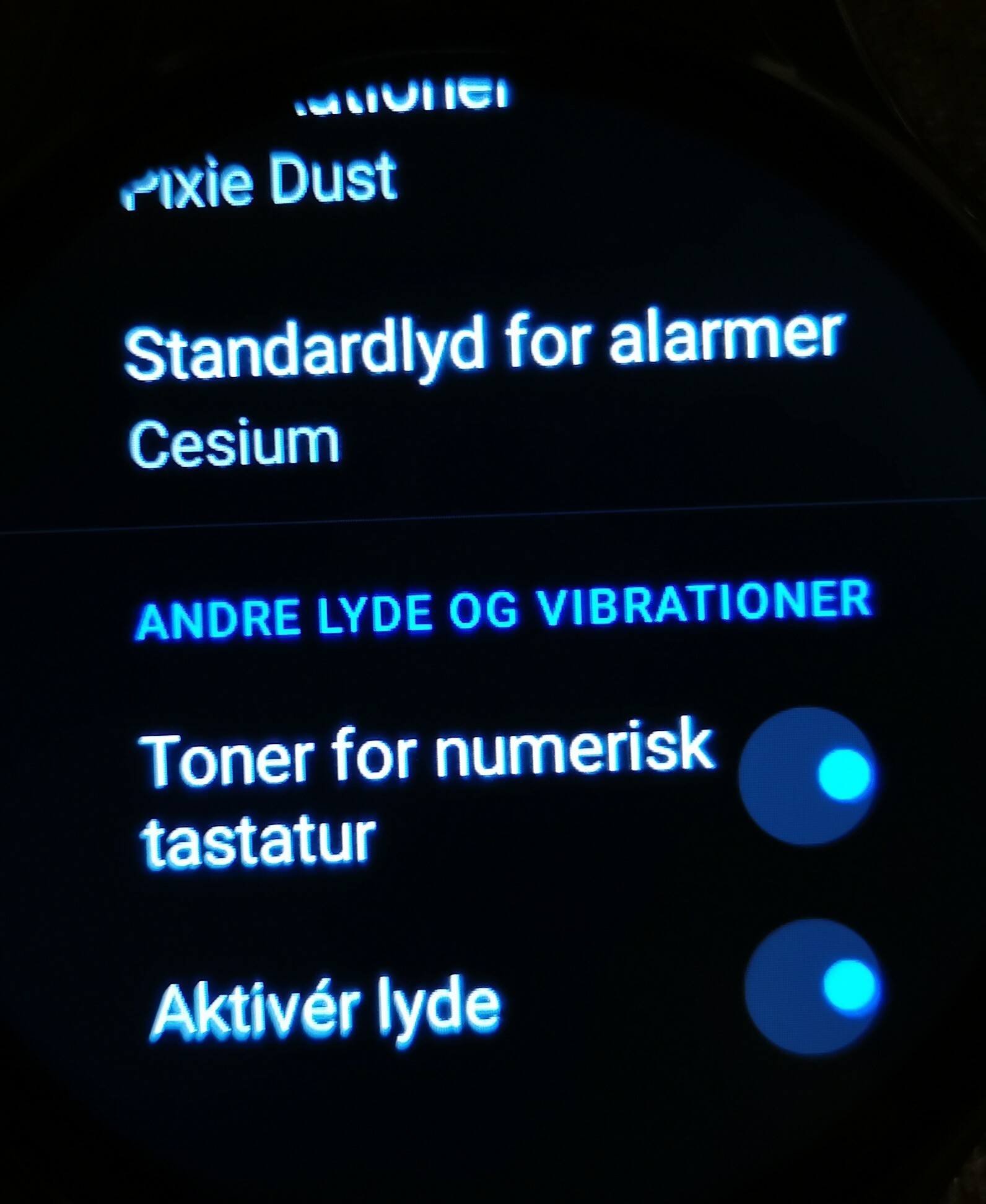

Thanks @pablo11, then it’s probably the bottom one of these, with a bad worded translation.
It says ā€œActivate soundsā€, probably they mean sounds on activation/boot. It looked like a general sound on/off switch…

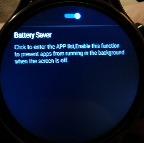

I may have solved the background killing:

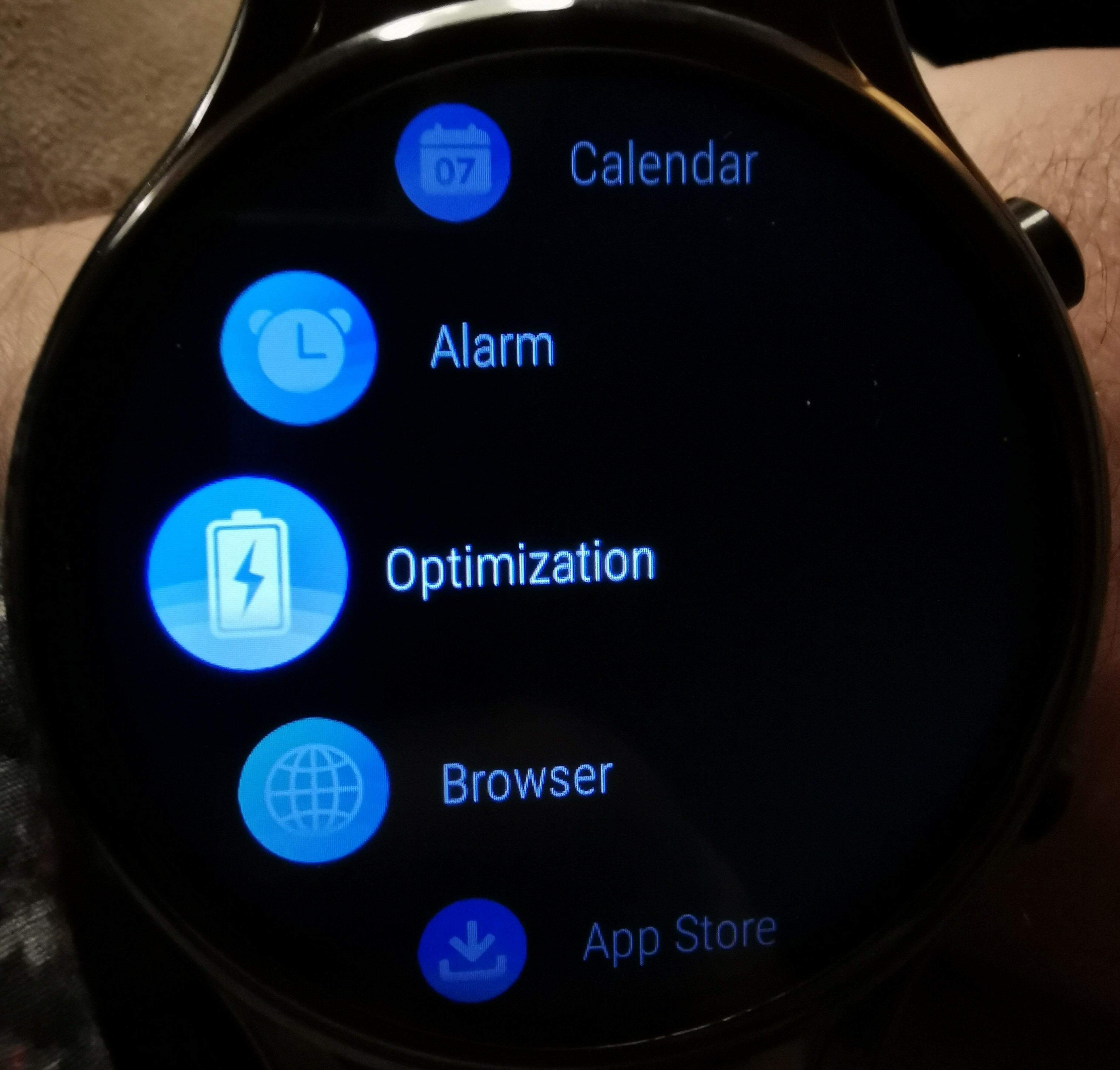

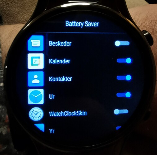

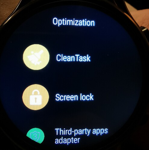

In addition to the new Android 10 settings, I found the old style background cleaner.
Optimization->Clean task->Battery saver
In there we also need to remove apps from the background cleaner. Pfheww, that took much searching…

Yeah I watched that as well and learned of the cleaner etc under optimization but I don’t recall any warnings that enabling cleaner might affect bluetooth. Anyhoo my Bluetooth (music) is going great so the world is full of rainbows and unicorns again.
It is going great because of what changes ?
Just to help others …
Hi Pablo11. It’s going great because I disabled the cleaner under optimization settings shown above, after my bluetooth music signal started cutting in and out (apparently because because I had enabled the cleaner to to stop 4 apps running in background)
