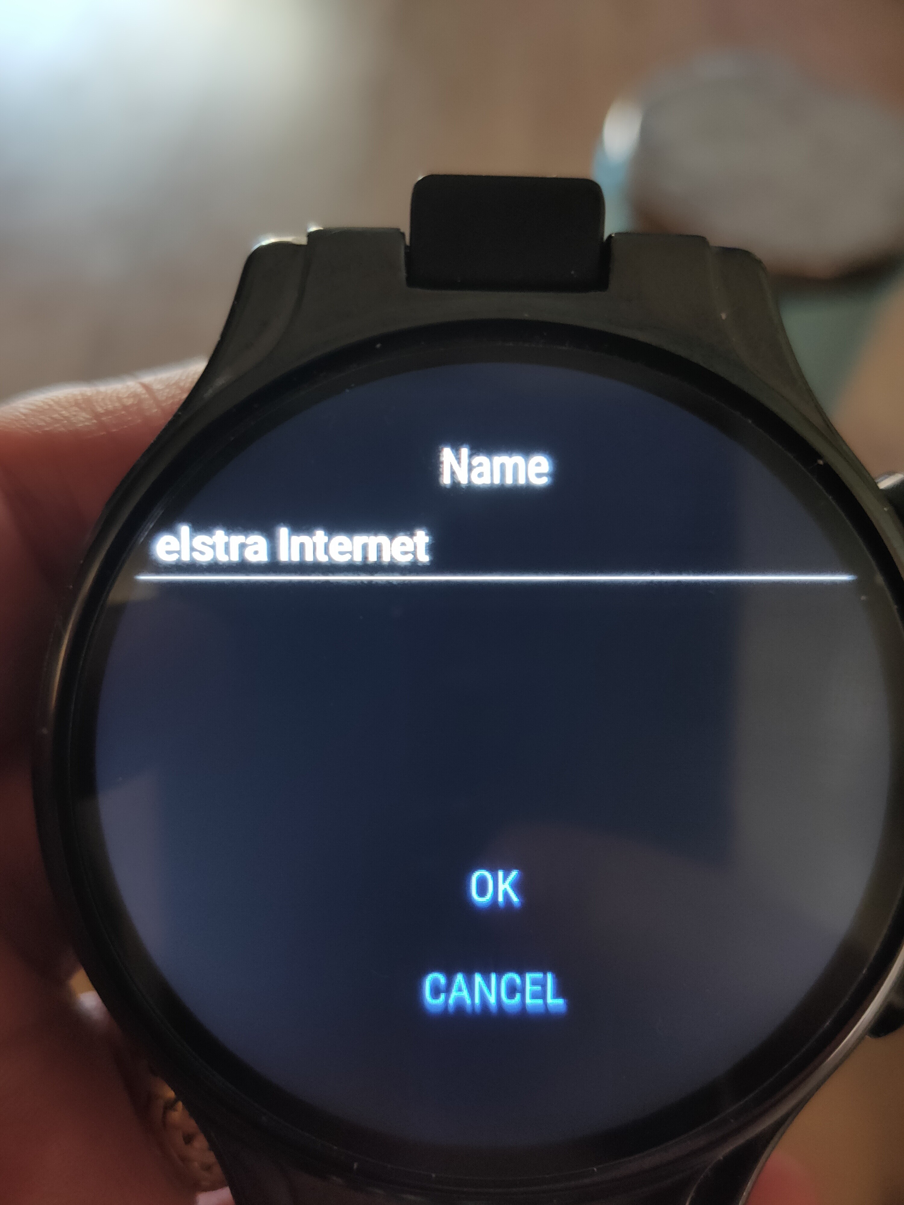

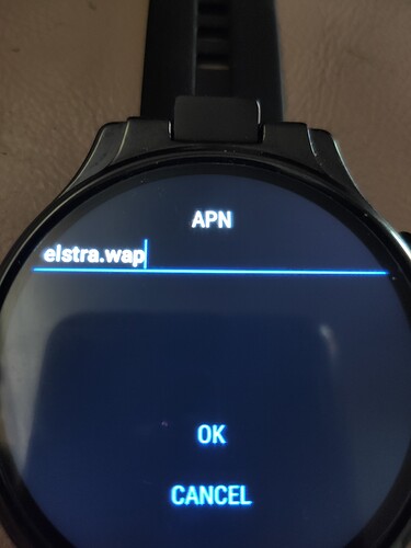

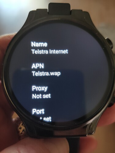

If I click on the telstra internet APN…
I can edit it no problem
Sorry the APN itself I mean

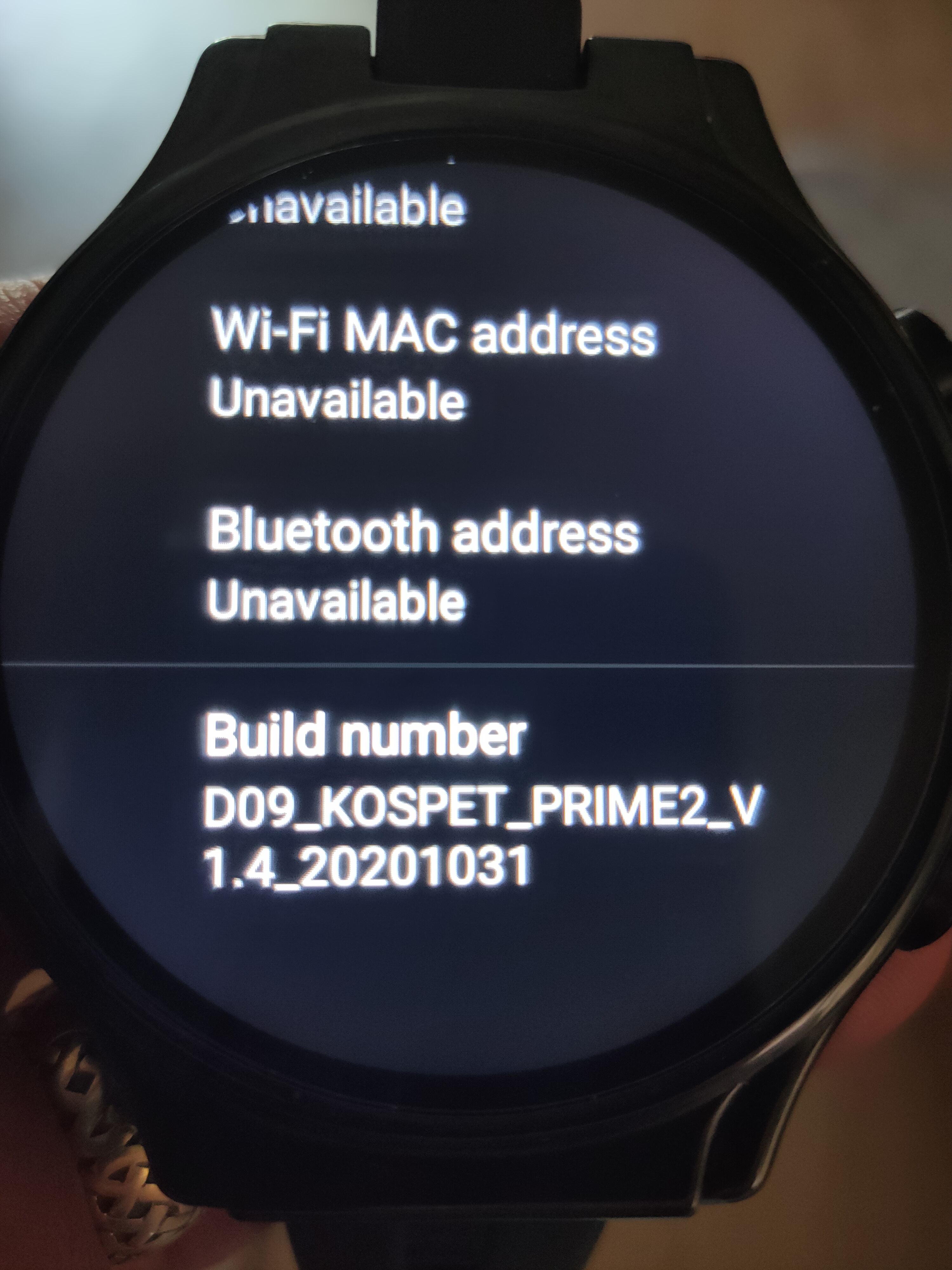

Can you confirm if you are on the v1.4 rom - the one you uploaded for updating?
Yes I already confirmed that.
Tried to flash the v1.1 that I had on it and had built a flashable rom from using MTK tools etc. but it wouldn’t let me flash it due to verified boot so I reflashed v1.4 and editing APN is still greyed out - can’t do it. Most phones I’ve had have been using the ATT sim by tracfone and I can usually edit the APN’s but I know some phones I’ve seen people talk about say they can’t edit the APN. I tried some Apps that normally can edit the APN but no luck on this watch. I suspect the SIM your are using is probably why you can edit it. So giving up for the night…
