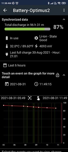

this the battery status of my optimus2 i put the watch in battery saver to test battery saver on FAW 1.3
can someone tell me is my watch giving the good backup
That is a problem with the touch panel driver and it happens when using stock firmware as well.
Last charge 9pm 30 August…
You need to let it fully discharge and see how long it takes to get there.
yes i charged at 9pm and then put it on battery saver.
Ok cool.
Let’s see how it goes.

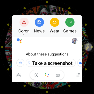

sr the texts are clear now on google assistant dat was happened because of the dark theme.
The google assistant is not working on lock screen. 🥲
Have you granted permission for notifications allowed on lock screen?
I’m actually curious why you are using a lock screen?
I must admit it something that I have never done in the 6 - 7 years I have been working with watches…
