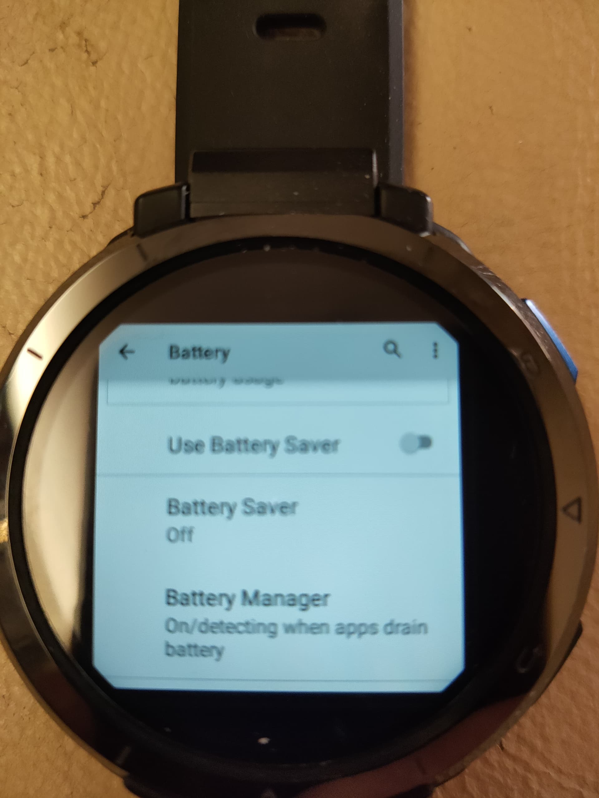

The sleep app is probably not compatible with this firmware.
There is a “use battery saver” switch and a scheduler for battery saver.
These are normal.
If you have any other options then it may need a factory reset.
