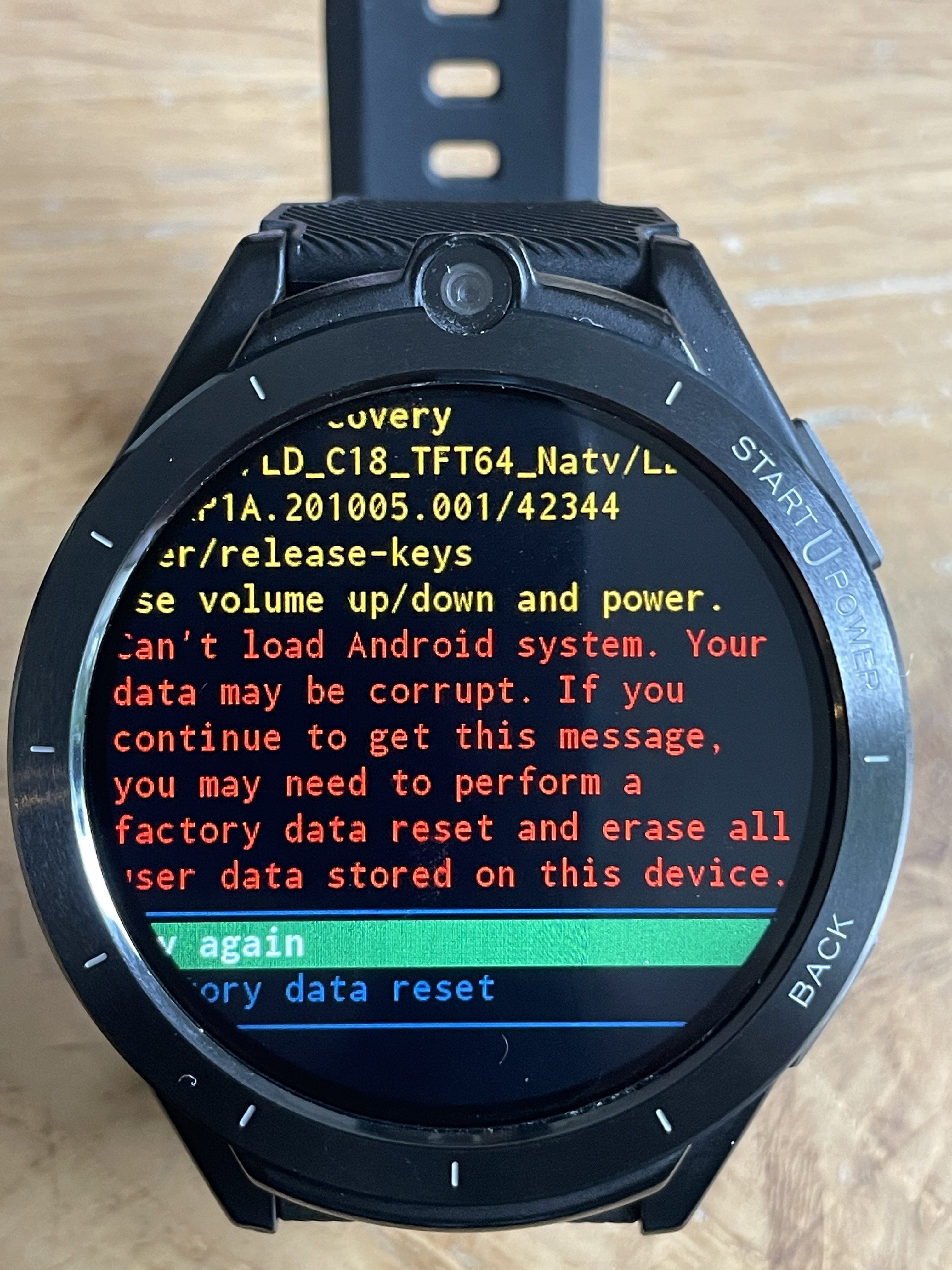

Hi guys, can I have a link to the flashtool please?
My Watch is stuck in recoverymode for some reason and reboot is not working. Option ‘factory data reset’ is out of reach because there is no volume up/down. Or maybe any other suggestions? Thanks!
you’ll find the latest firmware and the needed tools at the beginning of this post. The flashing process is described, too. It’s a bit different to mtk chips.
Thanks, and Google removed the link to the flashtool. The firmware was still available.
@Dr_Andy_Vishnu thanks for sending the link!
Did you read @G1NT0N1C comment that the MTK flashtool doesnt work with this watch ?
I read it only was different, now I understand it doesn’t work. Any suggestions on how to get this great watch going again?
As already mentioned, the flashing process is described at the beginning of this thread. You can find all the tools and information you need there.
When trying to download the Unisoc, GDrive says " **We’re sorry. You can’t access this item because it is in violation of our [Terms of Service]"
