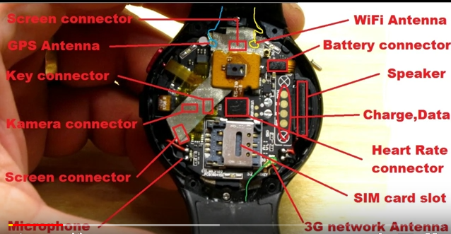

Hi Thanks for your suggestion.
I solved my problem by opening the watch, and I found out that the GPS antenna and the 3G network antenna are disconnected.  Once I plug it back, the 3G network connected and the GPS too.  The internal is exactly the same as LES1.
826.png.  What I concluded is that the item was defected from factory (in my case is no network signal and no GPS), and they flash a custom rom Z10-A-V07-20170615 (brand name changed to Z10-A and sell them as generic.  In my case, I bought mine from Aliexpress decribed as Lemado Z10 at the same price as other branded one, the vendor send the item as branded Lemado Z10 to Canada and hope no return from me due to high postal cost to send it back.
So be careful if your rom shows Z10-A-V07-20170605, you might probably experienced other problems or similar problems.
KK
ref: the picture is from: hXXps://www.youtube.com/watch?v=7SSzfNoGYXE
