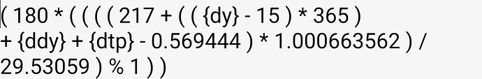

A good example is the popular moon phase: In the clockskin format, array type 19 is used in combination with 8 images. While the moon phase display in the “.watch” format is more precise, the required formula:
is certainly not readily understandable for every layperson.

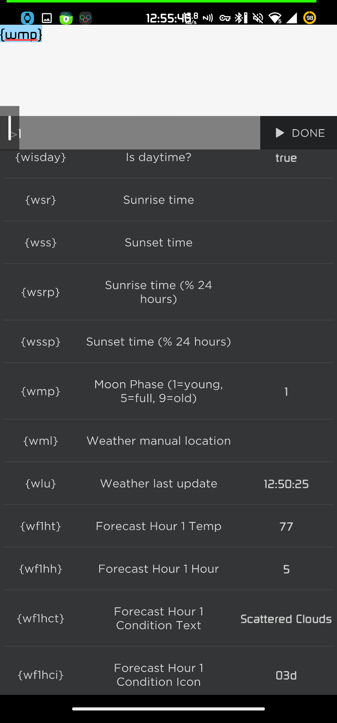

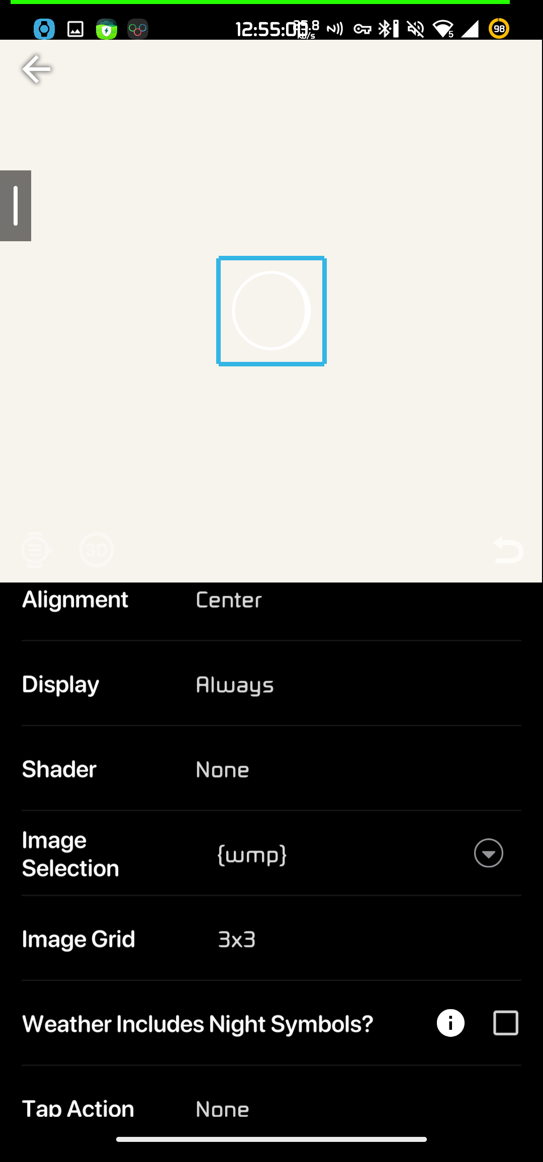

Not sure what ancient watchmaker version are you using, the one I use is not latest either because can’t find crack and are too lazy to crack my self(and the latest have a bug the watch face can not change to square), but it already have {wmp} tag so no need for the math
