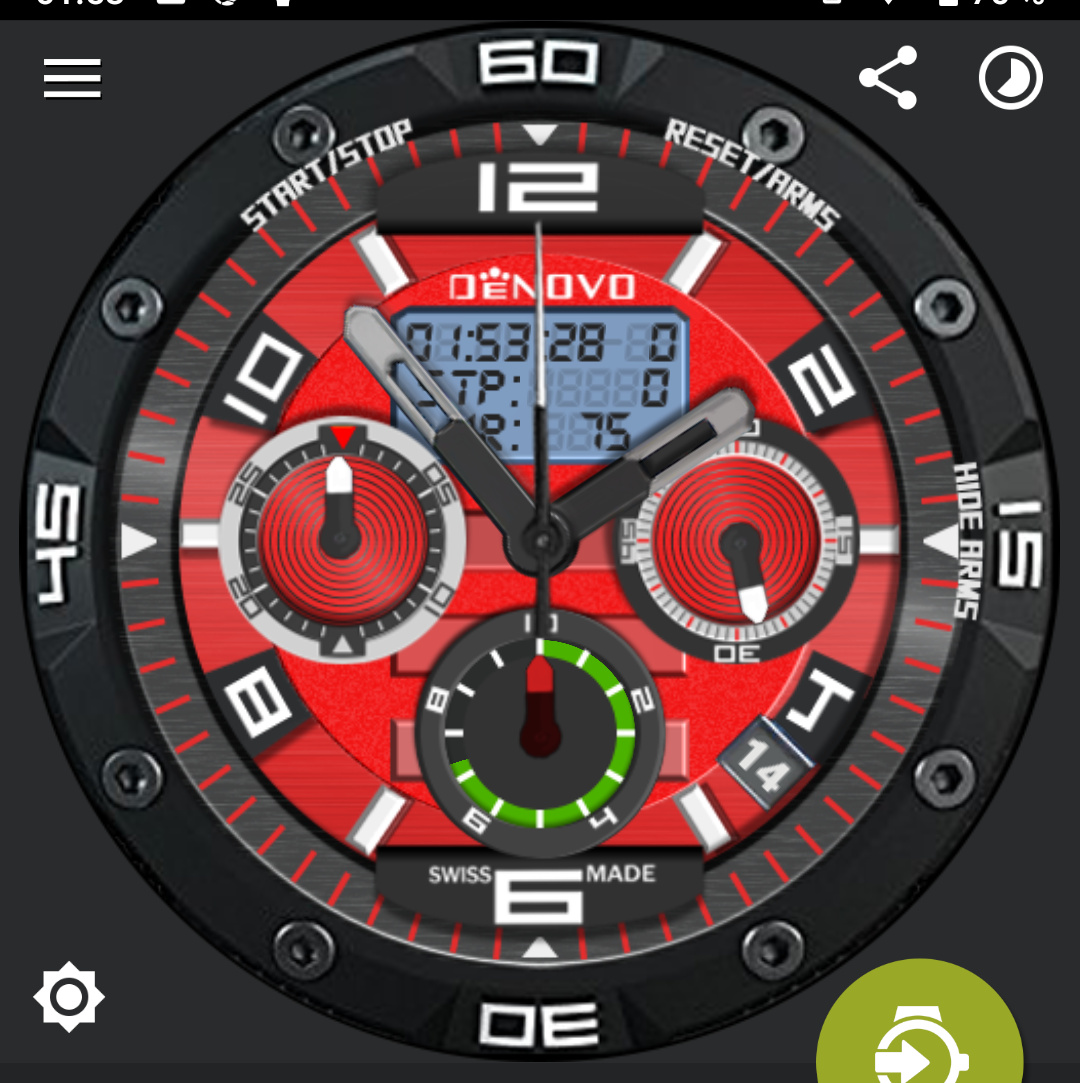

Middle ring is battery indicator that also shifts color. I programmed it with watchmaker {bc} code and it works in the latest universal launcher. (yes you can zoom away the bezel).
In fact, the {bc} code I used, was placed inside a watchmaker segment progress shader. So it’s impressive UL spotted the code at all. ( I run thor pro 3G)
