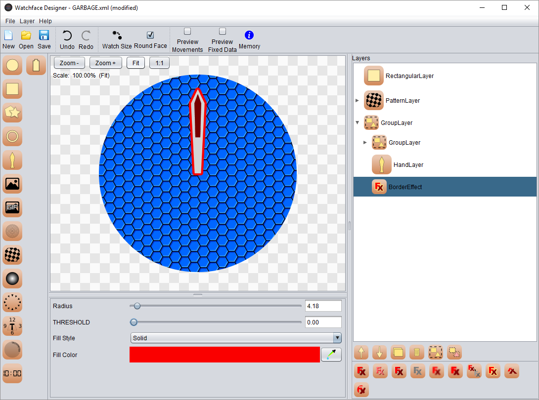

When I apply BORDER EFFECT to a partially transparent image, the transparent area turns into the border selected color. That makes me thought that, what this effect really does is put under the selected object a copy of that object in the selected color, with a higher size, specified with the RADIO parameter, instead of apply a “real” border to the object.
Can this behaviour be changed in order to have a “real” border and can by applied to transparent images?
I attach an example

Your description is close. What it really does is go through all of the objects pixels and "replace" each pixel with a circle of the given radius on the given color but with the alpha equal to the pixel alpha. And then, draw the original object over the "border". That's almost the way I think Photoshop/Gimp/Affinity photo works, except those do not care about the alpha, so they always draw the circle on full opacity whenever the source pixel as an opacity > 0. I personally prefer my interpretation of border . However, the problem remains, what's the border of a semi-transparent image (or part of image)?
What I can do, if you think it would help, is to add some sort of opacity threshold to ignore semi-transparent pixels (act as if they where fully transparent). It won’t solve all cases, but I believe it could “sort of” solve yours… See attachments for “Before threshold” (threshold=0) and “After threshold” (threshold=1) to see the difference of having this setting or not having it.

Jan 25, 2018 21:15:26 GMT 1 mpmf said:
Jan 24, 2018 20:46:48 GMT 1 tcc said:
Hi everybody,
I don’t know if this is a bug.
I attach an example
Great, Marco! I think, watching your images, that this could be a good fix. I’ll test it with my example and we’ll see, but it looks good!.

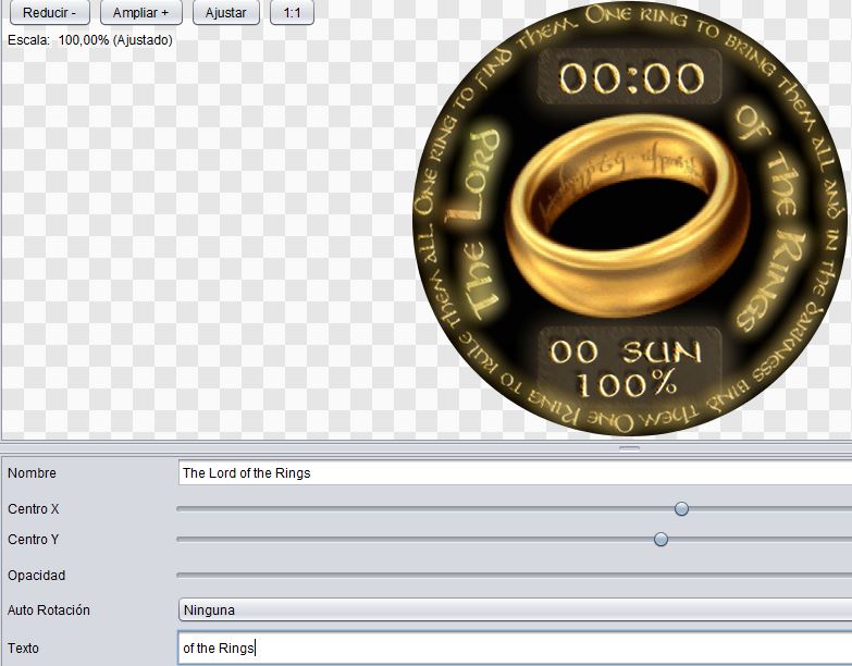

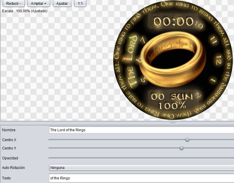

Hi everybody!
  1. BUG: After loading my last project, one of the TEXT LAYER didn’t draw the text typed previously, instead draw numbers, but in the TEXT property was the correct text. After copy and paste again the text, it draw correctly. I attach images.
  2. QUESTION: In the TEXT property of a TEXT LAYER, the commas (,) separate pieces of text, so how can you write a real comma, not for separate texts?
Thanks in advance!

Jan 28, 2018 0:15:05 GMT 1 tcc said:
Hi everybody!
Thanks in advance!
Hmmm. I wonder what might have happened to 1)... :S
Right now, it’s impossible to place commas. Yes, that’s a big one missing I’ll try to make some escape character to enable the writing of commas. That’s what happens when we don’t think ahead. When I created the TextLayer, the intended use case was only to place the numbers/days/months… It didn’t even occur to me to place free text… I’m such a noob
