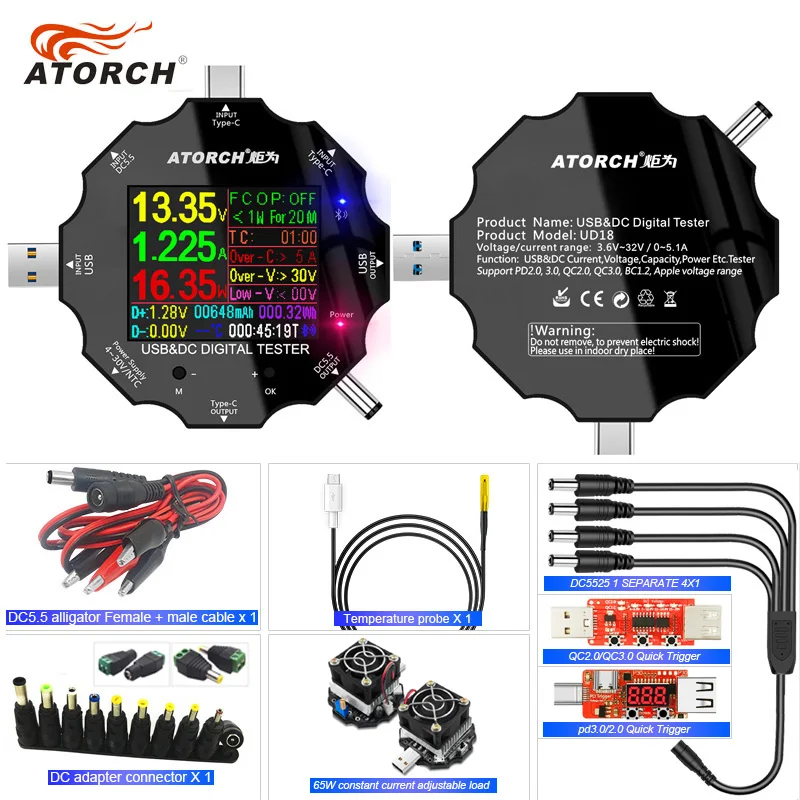

Can it cut off power on criteria ?
Did you try the UD18 or UD24 ?
It does not have the ability to stop a charge. Only the device controls the charge circuit. I did not try those models.

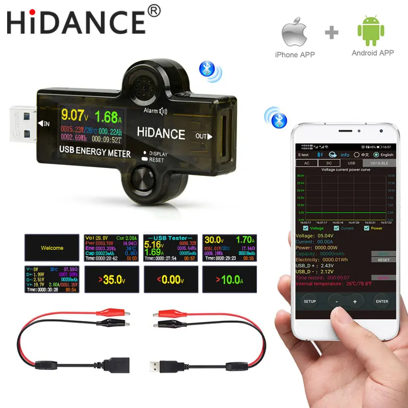

I own this one, which is cheap and has bluetooth connectivity: https://a.aliexpress.com/_mN2q2v7
It works very well, I’m quite happy with it!

I bought the Atorch T18, and it (finally) arrived today, after a long time travel, then held back by customs (even though under the free max amount), and postal service claiming they couldn’t deliver because of incomplete address (while the address label was perfect on the package I received)
I chose it because it has power cut off after selected min charging level and time, so it can switch off the power when changing has ended. And it has a phone app for basic display and programming settings.
